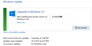

    In my earlier post, I asked for ideas about blocking the Windows 10 upgrade from Win 7 or Win 8.1, in a very late stage. For most people, running GWX Control Panel from Josh Mayfield will keep Win 7 or 8.1 from installing Windows 10. However, it doesn’t work for everybody. In particular, people in a very late stage of the Windows 10 forced march will see the dialog shown here whenever they go into Windows Update. It’s scary because it looks like you have no option except to install Windows 10.

    If you have a Win7 or Win 8.1 machine that’s stuck in the “Upgrade to Windows 10” dialog – the one shown here – could you do me (and about a million other people) a huge favor?
    Click on the link to Show all available updates.
    Check the box on one of the updates.
    Uncheck the box that says “Upgrade to Windows 10”
    Install updates.
    Your machine should show that it’s installing Windows 10 – but in a minute or two or three, it’ll come back showing that it’s installed the one update you selected, and not the Windows 10 update. It may even show that one of the selected installations has failed – the Windows 10 update.
