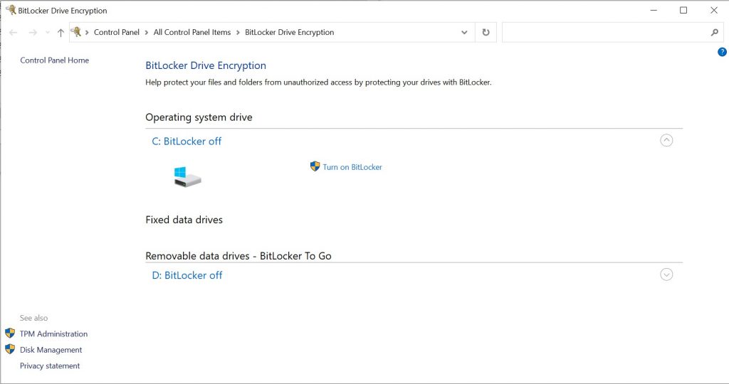

    If you haven’t installed KB5012170, first check to see if you have bitlocker enabled. To see if you do, click on start, then on search and type in bitlocker. You will see a “manage bitlocker”. Review that bitlocker is off.  If it’s on and YOU don’t know where that recovery key is, click in this window to turn it off. You can easily turn it off from this interface.
