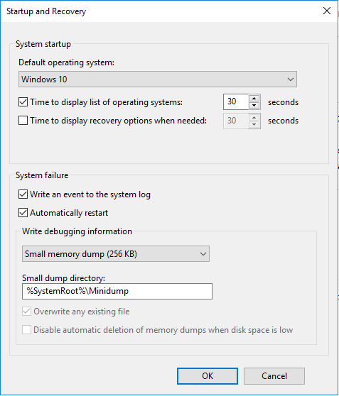

      Small-memory-dump

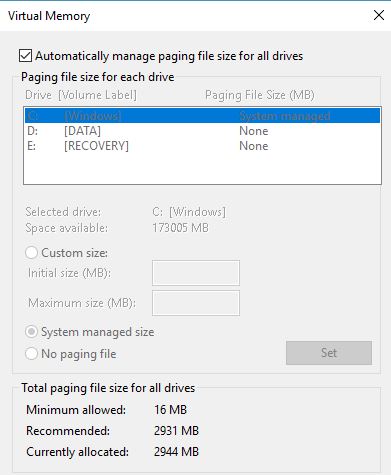

        2. Regarding your suggestion #2, to change the size of the page file, I have to click on Change… which takes me to a rather complicated looking page. Can you show me what to change here:

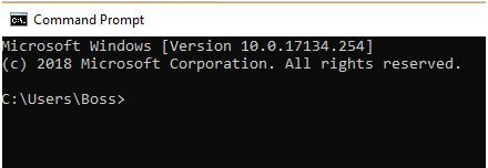

        3. When I open the Command Prompt, this is what I see:
        Command-Prompt-screenshot
        How to I get to C:WINDOWS? Do I type the same thing even though my Windows 10 is 64-bit?

          Re 2: Untick Automatically Managed, then click the Custom radio button. Add (as suggested by @ch100) 512MB as Initial Size. You might want to try 1024 as the Maximum Size. Click Set to save it.
          Re 3: type at the command prompt:
          cd c:\windows
          (cd is the command for “change directory”, then a space, then the drive you want to change to).
          This is to enable the change to disable hibernation. You will also have an option to do that within your power settings.

          @artistann deselect the button and the top of configure memory settings that says “Automatically configure paging file for all drives” then enter the values below that wish to enter for the particular drive to tweak you Paging file/Virtual Memory.

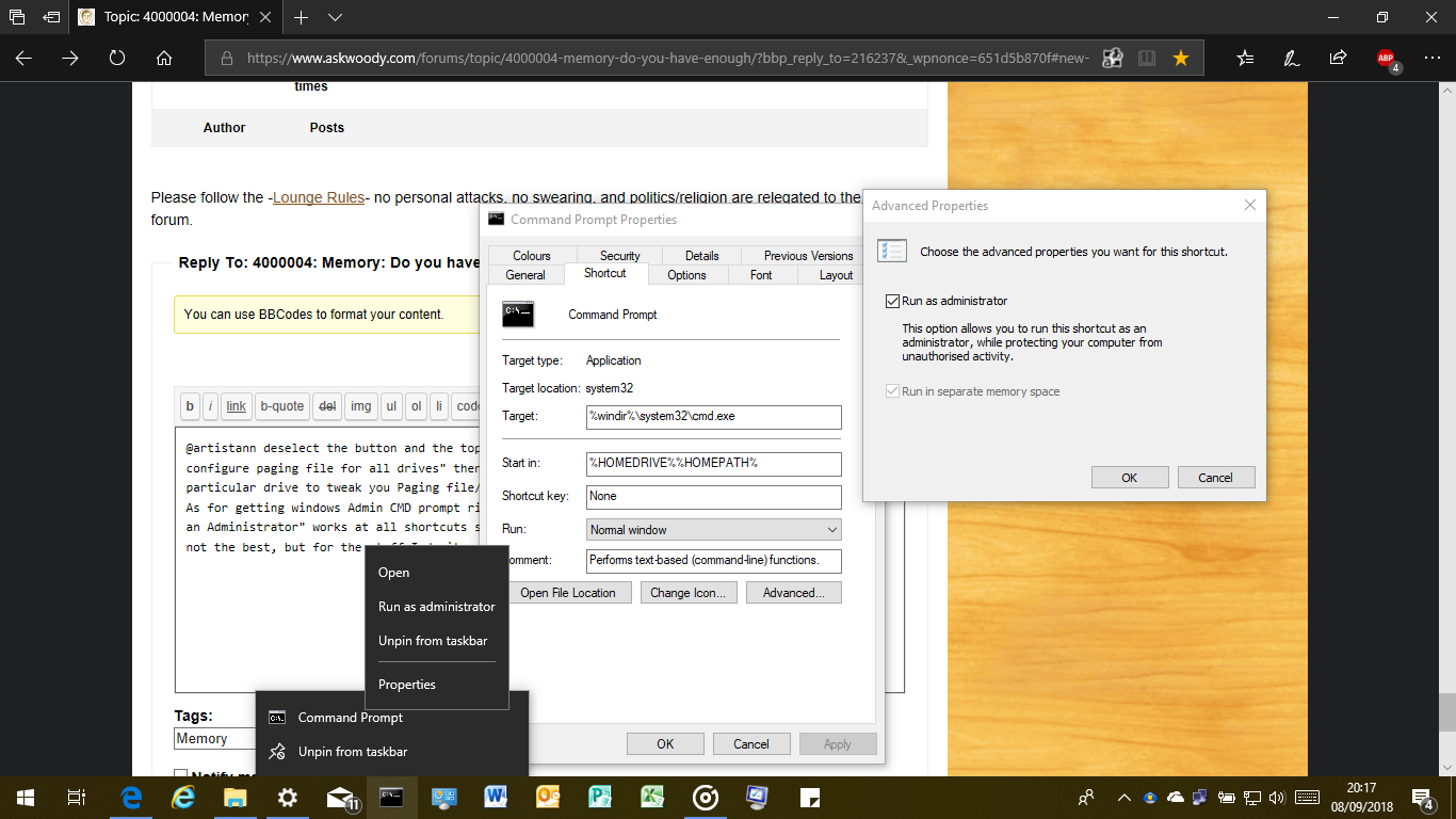

          As for getting windows Admin CMD prompt right click on short cut for CMD prompt and select “Run as an Administrator” works at all shortcuts start menu entries I have mine set as default, probably not the best, but for the stuff I do it saves messing around hope that helps 🙂
          Set-Shortcut-to-display-admin-CMD-prompt-every-time
