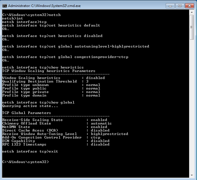

      In relation to bufferbloat, until this is widely resolved, in Windows 7 try this configuration:
      Open a command prompt and run as Administrator:
      netsh
      int
      tcp
      set heuristics default
      set heuristics disabled
      set global autotuninglevel=highlyrestricted
      set global congestionprovider=ctcp
      You can fiddle with the other settings, but those above are related to buffers and internet speed and latency.
      autotuninglevel-highlyrestricted

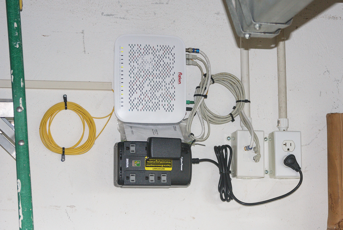

      We have Fiber To The Home in my neighborhood, via Hotwire Communications “fision” service. Their ZTE optical network terminator (ONT) is in my garage, with separate gigabit Ethernet links to my router and their IPTV box.
      ZTEONT

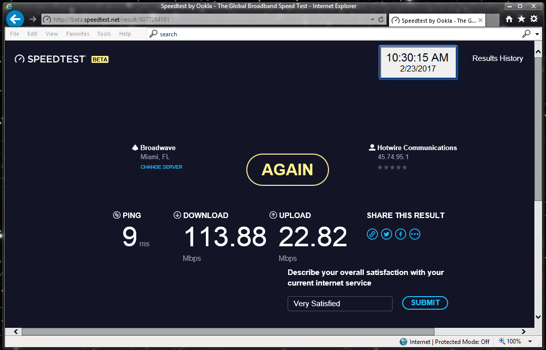

      I have to say, whenever I’ve tested it I’ve always gotten better than advertised speeds, which at the moment are 100 megabits downlink, 20 megabits uplink.
      SpeedTest
      SpeedTest2
