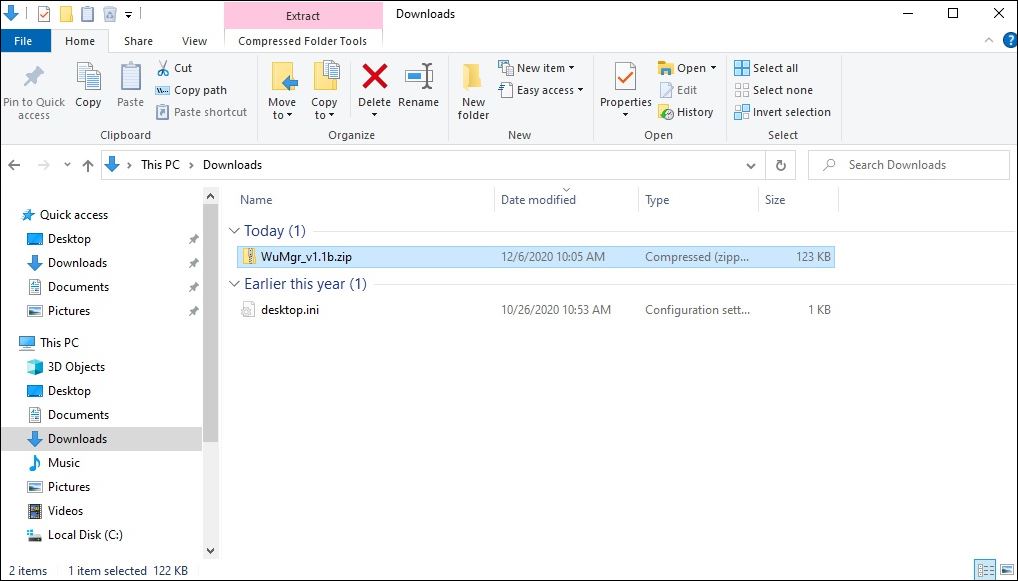

    Save file:
    wum09b

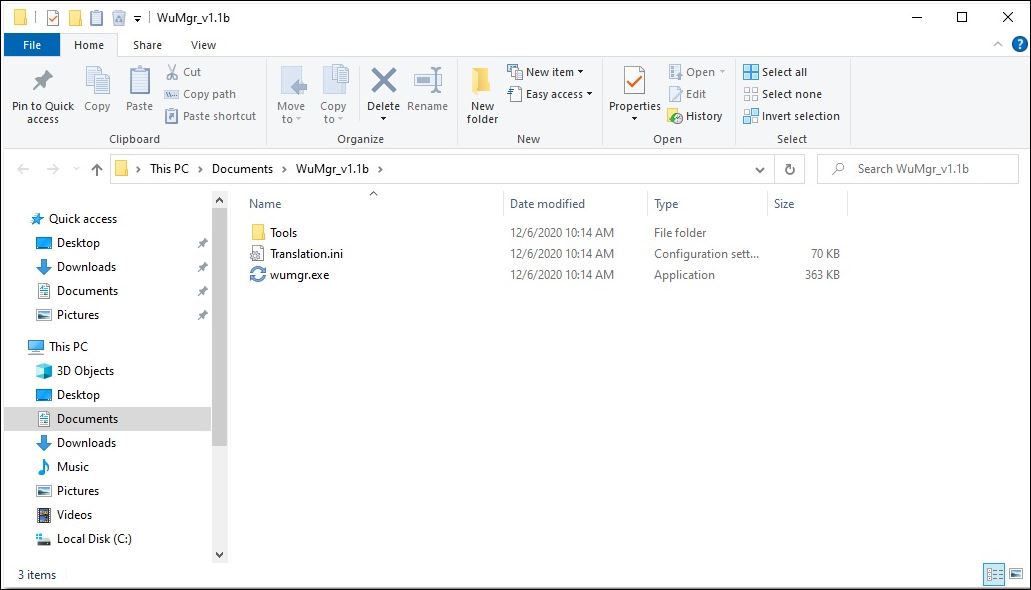

    Extract files:
    wum10b
    I extracted files here:
    wum11b
    The executable file is here. Click on it to run it.
    wum12b

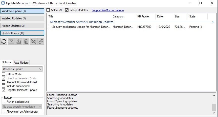

    There are six selections for WuMgr from left to right they are:
    Circle: Search
    Down arrow: Download
    Down arrow with box: Install
    Trash: Uninstall
    Eye: Hide
    Chain: Links
    wum00
    Select the circle on the far left.
    wum01-2
    Check the update you wish to install.
    Select the box with the down arrow.
    wum02-2
    The update will download and install.
    wum03-2

      Run WuMgr and click the search button (arrows forming a circle).
      You will see a list of available updates and can select any and choose an action for those.

      In WuMgr under the Auto Update tab I have the following settings greyed out.
      Block Access to WU Servers
      Notification Only
      Download Only
      Scheduled Installation
      Does anyone have a clue why?
      Cheers

          I’m new to WuMgr and have only performed tasks on it on 1 occasion, installed the March updates. I previously used wushowhide and ‘pause updates’ for xx days setting in Win10 Home with good success rates.
          AutoUpdateTab
          • #2438803
            Mine also looks like that. I think that’s just the way it works with Win10 Home.
            I vaguely remember that other types of Win10 (Pro etc) may be slightly different with some options not greyed out. Maybe someone else could confirm.
    • #2438814
      It’s the same for me on W10 Home with no registry hacks.
