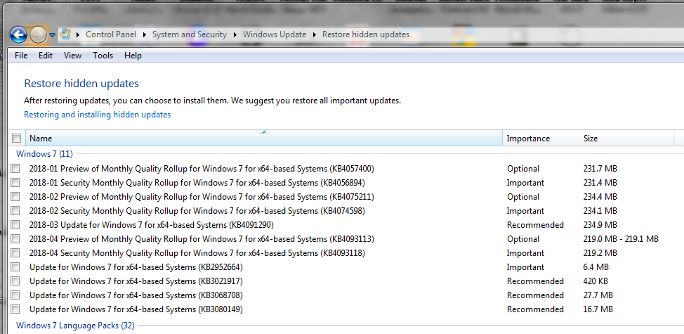

      While looking a solution for dwm.exe issues after install of yet any rollup/preview of 2018 I maybe tested all options concerning KB4099950 available of its both old & new revision including its install/uninstall before & after install of either KB4093118 or KB4093108.
      Well, there were neither any issues nor any difference. So KB4099950 finally removed.
      BTW here is a list of my currently hidden updates when KB4099950 is absent – Win7 March Rollup KB4088875 & Preview KB4088881 vanished upon KB4099950 removal.
      2018-04-25-Wed_1_M4300SSDHiddenUpdatesOf11Total_1OfWin103OfTelemetryKB4056894KB4057400KB4074598KB4075211KB4091290KB4093118KB4093113
