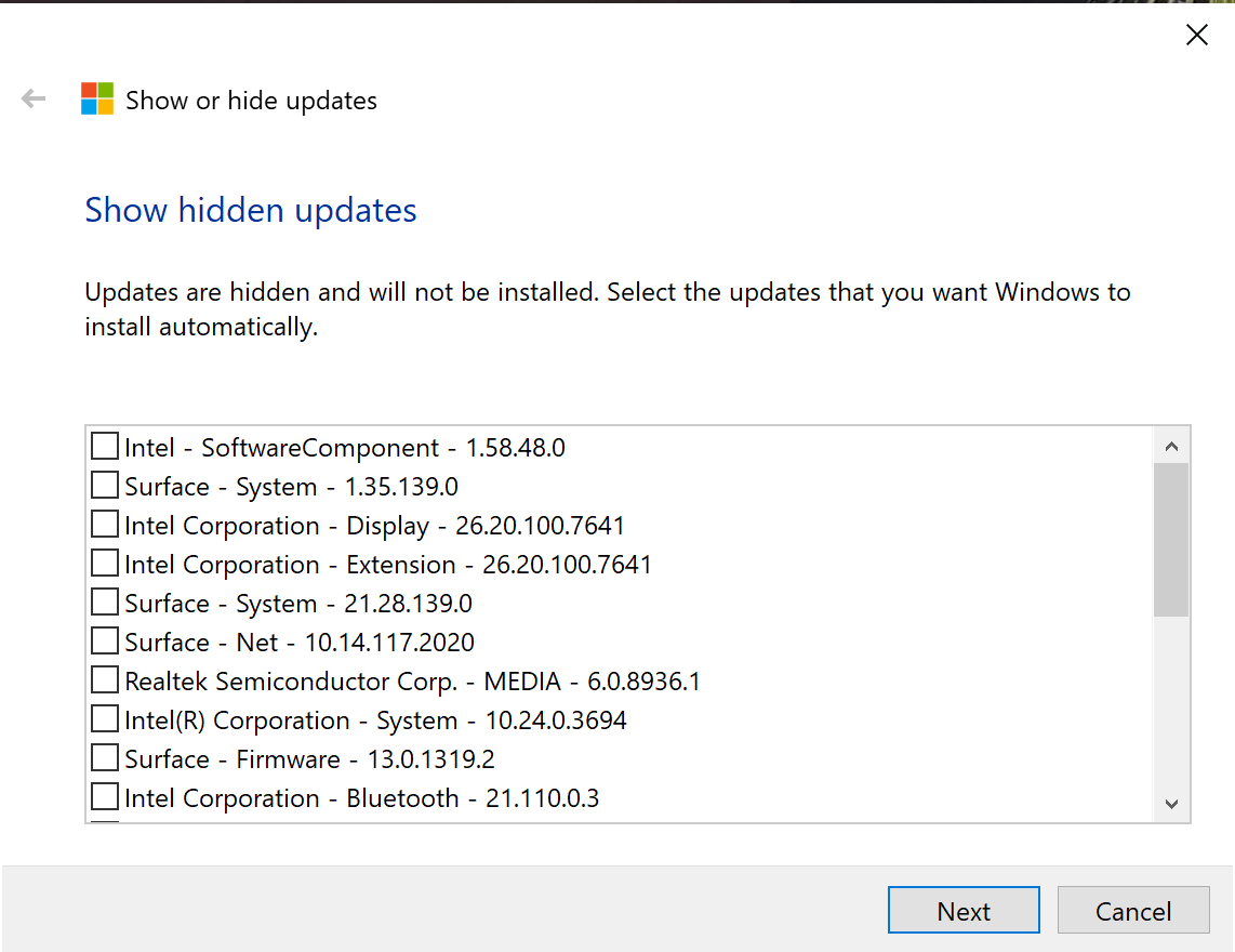

ManagerI am not familiar with the Surface line of computers, but @doneager needs some advice of which, if any, drivers for his new Surface 7 are safe to download from Windows Update.
The Surface 7 came with Win10 Home v1903 Build 18362.418 which has been upgraded to v1909 Home Build 18363.1256. It will eventually be converted to Win10 Pro. See Topic here for reference.
wushowhide shows numerous drivers and firmware updates available. Some have been hidden, and some are just showing available.
My normal reaction is not to accept drivers through WU, but this is an MS product and they are being offered through WU.
So the questions are:
Do you have experience with Surface products?
And which updates (or type of updates) are safe to accept through WU?
TIA

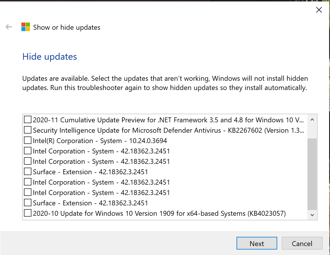

ManagerThe Surface Pro 7 Update History linked by @b says
Currently, there are no known issues. If you feel that your Surface device is not working correctly, you can Fix common Surface problems using the Surface Diagnostic Toolkit.
And, both @b and @joep517 seem to have little problems with the drivers offered by WU (except for a possible Intel Desplay being older, which can be handled)
So, I think it is probably safe to go ahead and install the available drivers.However, there are some updates that are available to be hidden that you should try to hide:
KB4023057 This one definitely needs to be hidden.
Two incidents of Cumulative Update Preview for .NET. You may not be able to hide these due to the way MS has configured them, so if you can, OK and if you can’t, they can be installed.+ So, UNHIDE the ones that are hidden. They are all drivers and firmware.
+ Run wushowhide and HIDE (or try to hide) the three listed above if they show up.
+ Rerun wushowhide and verify what is hidden.
+ Rerun wushowhide and go through the list of updates available to be hidden.
If there are only drivers left (and maybe the .NET Previews if they won’t hide).
+ Wait for Windows Update to rescan on its own (you can monitor the last-run date). DO NOT “Check for updates.”
+ Then go through the list that shows up in the Windows Update queue in the Settings App, and be sure there is nothing there but the drivers (and maybe .NET Previews).
+ If the only updates in the queue are the drivers (and maybe the .NET Previews if they won’t hide), go ahead and turn Metered connections OFF and let them install. If there is anything else there but drivers, wait and ask first.
+ When it asks you to “Restart” – turn metered connections back ON before you restart.Let me know what happens.

AskWoody PlusThe following non-drivers were listed as available to hide: Security Update for Adobe, MSRT and Defender AV update. These didn’t appear threatening, so I didn’t hide them. Been waiting for about 4 hours for these updates to show up on Windows Update page. It shows last checked of 12/1920 @ 6:13 AM. Should I just keep waiting and checking?
December 23, 2020 at 7:02 pm #2322347
December 23, 2020 at 8:07 pm #2322357
doneager
AskWoody PlusThey finally showed up! 28 of of 31 actually updated per history. The 3 that didn’t were all the same: Intel Corporation – System – 42.18362.3.2451. 2 others of this same update DID install. All these installed with metered connection ON. I think that’s normal for these types of updates. Was never asked to restart. After clicking download, they just took off. Metered remains ON. Only two items remain hidden: .NET preview KB4586878 and the notorious KB4023057. Only 1 item shows available to hide, a Defender AV update. Installing that now.
Looks good to me. What say you?
