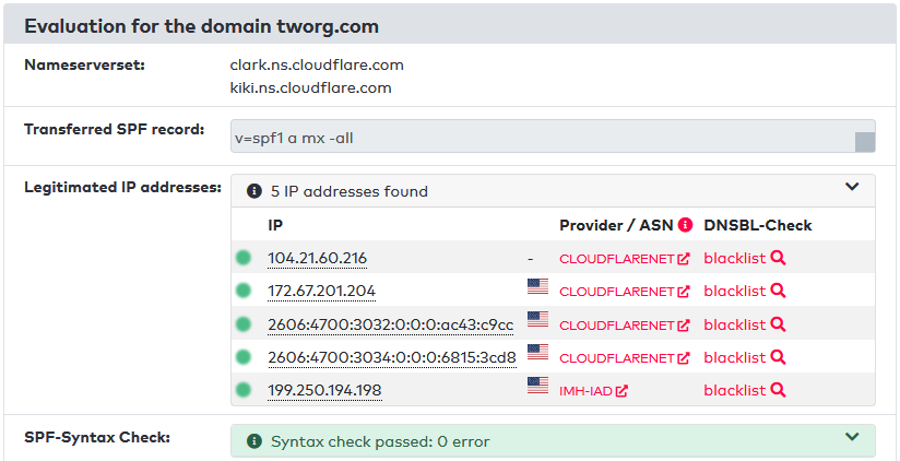

      Anyway, I used another link to a site that generates an SPF record for the input domain (using the existing DNS A and MX records for that domain) and here’s what it created for your tworg.com domain.
      v=spf1 a mx -all
      Which will allow the following IP addresses to send e-mail (4 Cloudflare and 1 InMotion Hosting.)
      tworg
      Note: InMotion Hosting also owns the IP address specified in your mygoforthegreen.com SPF record.
      I’d suggest you update the SPF record for tworg.com with these new settings and see if it fixes your gmail problem. If it doesn’t work, you can always put it back like it was; although we already know that’s not the correct settings.

    • #2564518
      Hi again, alejr, and HUGE thanks (sorry for yelling, but your response is so fantastically helpful and instructive)!!
      I read through each step and your excellent explanations. I’ve now changed both TXT content fields by copying and pasting what you gave me. Checking with the cmd prompt, I received “Non-authoritative answers” to both txt entries with the new edited content listed.
      So that looks like my local DNS (Comcast, it seems) has received both edits. Am I correct?

      Strange thing is, doing that for your tworg.com domain did work… except gmail still refused to accept mail from tworg.
      • #2564755
        Love your emojis…and appreciate your plowing through despite the numerous twists and turns this issue is providing you!
        Strangely, even though it’s also an Inmotion Hosting IP, the 198.46.81.47 specified in your gftg SPF record isn’t one of those 154 IP’s??
        That truly is strange. It is the IP for our site so you’d think it would be in the InMotion Hosting list. If things work with the new code I’ve just copied we just won’t worry about it!
        The update I suggested was not to remove the “A record” for your site (doing that would cause the whole site to stop working) but to remove the a reference from the “SPF record” (which causes it to use the A record’s info as part of the mail server verification process.)
        Thanks for clarifying this. More proof that “a little knowledge is a dangerous thing”! I hadn’t done anything to that record so no problem.
        Appreciate your researching that “include” issue and discovering it’s an InMotion thing and so should be included after all.
        I’ve now added your edited code to both DNS records and will send test emails. Once I have, I’ll post back results.
        Many thanks, alejr, for all the research and time you have put into getting this fixed for me. I hope it’s been a learning experience (albeit a rather dragged out one) for you … it sure has been for me!
        Back soon…
    • #2564801
      I think you’ve done it! My original Gmail tester hasn’t replied yet, but a second Gmail tester just did. My tworg email went through to her and none have come back as rejected!
      Until the original tester replies I won’t feel 100% certain, but that’s just me. If none of the test emails came back I think we’re there. Wonderful!!
      You have been so patient and so helpful, alejr, I just can’t thank you enough. All the testing you did and additional research to find out what was causing the problem and how to fix it was way above and beyond and I sure appreciate it…and you for doing it all.
      Thanks so much. I’ll post back again when I hear back from the original tester…a final proof! 😉
      Linda
    • #2564807
      Always willing to help were I can and glad to hear things appear to have finally been resolved!
    • #2564819
      Am waiting until tomorrow to be sure final testers have replied (but I’m feeling pretty good about its having been fixed). And I’m really glad you are (and were) willing to help! 🙂
    • #2564930
      It’s half way through tomorrow now…all tester gmail emails went out and were replied to from both gftg and tworg addresses.
      The problem is resolved (at last, given all the time and effort you put into it, alejr). Thanks again and thank goodness for this Lounge and all you generous Loungers! 🙂
      Now to reread all the posts for more learning…
      Linda
    • #2564932
      P.S. Forgot to click “resolved” so am doing so now.
