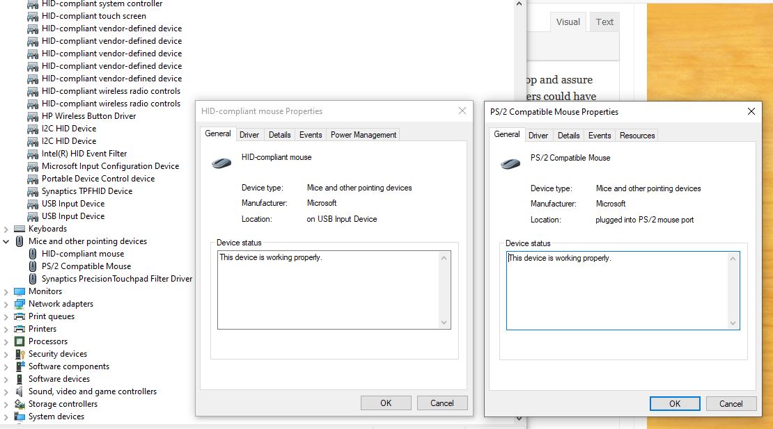

AskWoody PlusOne might check the USB/USB3 drivers for your laptop and assure latest from your manufacturer……… depending on how you update, your drivers could have been changed…
OK, another question about the drivers. I looked in my device manager and see a lot of Human Interface Devices – 4 of which look like they may be related to the USB.
I also see several mice listed under Mice.
All of these can have drivers updated – how do I know which might be drivers actually related to the USB ports?
Thanks!! Hoping to have a more specific testing plan for all of this after my updates.
March 4, 2021 at 3:46 pm #2348015
Ascaris
AskWoody_MVPThe PS/2 mouse is almost certainly the touchpad. The “HID-compliant mouse” should be the one. I would try not just updating the drivers, but (unless someone already suggested this, in which case I apologize) going to the power settings for each of the devices in question and unchecking the “allow Windows to turn off this device to save power” button.
If it has worked before, it is possible that it might be related to an update, as you mention. It could be a system update or a driver update Windows slipped in there. Will Windows allow you to roll back some of the recent updates to find out?
Have you tried waking the unit with the power button? Just a momentary press, not a force-off. My Dell G3 requires this… the keyboard or mouse won’t wake it. I like it that way, so I haven’t tried to “fix” it. I may have even changed something to make it behave that way on purpose at some point in the past. I make so many changes that I don’t always remember them all.
I had something much like your issue happen in Linux before with my desktop PC. When I give the sleep order, it does go to sleep, but I can’t wake it up. When I look at the system log or diagnostic messages (dmesg), I can see that despite it obviously going to sleep by all the usual signs, it doesn’t actually reach the target of system standby (sleep)… it’s still waiting for some device on the system to report that it is entering sleep, even though the whole system does actually sleep.
Because of that, the “go to sleep” command is never fully completed, and it never wakes up because it is too busy waiting for the “go to sleep” command to finish before it can begin listening for the wake event.
If the device causing the issue is unplugged, it no longer exists as far as the PC is concerned, so the system no longer needs to wait for it to confirm it is entering sleep mode. With the blocking device gone, it is able to get on with things and process the “wake up” command you already gave.
If this is what is happening for you, it could very well be from the update that most recently happened. It could also be a driver update, if there was one. I haven’t had this issue happen on my desktop for some time, fortunately, and I am not really sure what fixed it. For me, it was not a consistent thing… it usually went into standby (sleep) when I told it to, along with waking normally. Every now and then, it would do just like what you describe.
If you were using Linux, I would suggest trying a newer kernel (or booting with the old one, if there had been a recent update… the old kernel remains installed after the new one is installed, so all you have to do is select it from GRUB), or perhaps changing the boot parameters, or changing the sleep method (there are a few different ways to initiate it), but in Windows 10, I don’t know.

March 5, 2021 at 6:29 am #2348105
LHiggins
AskWoody PlusThanks so much for the reply and your many ideas and suggestions!!
The “HID-compliant mouse” should be the one. I would try not just updating the drivers, but going to the power settings for each of the devices in question and unchecking the “allow Windows to turn off this device to save power” button.
OK a question about that – it is the one under “Mice” that would need the driver update – not the USB port itself? In the course of this, I did try several different USB mice, and also one Bluetooth mouse that was not connected at all, which was making me think that perhaps the port itself needed the driver update? But if it happened with the Bluetooth, then no port is involved, right? So something else?

March 5, 2021 at 7:50 am #2348116
Ascaris
AskWoody_MVPOK a question about that – it is the one under “Mice” that would need the driver update – not the USB port itself? In the course of this, I did try several different USB mice, and also one Bluetooth mouse that was not connected at all, which was making me think that perhaps the port itself needed the driver update?
All of the mice probably used the same Microsoft HID driver, so if there is an issue with that, it could happen on different mice. It’s just a guess at this point, though, so if one thing doesn’t help, then you’ve at least eliminated that item from the list, and you can try something else.
Also, I did uncheck the “allow Windows” boxes, but it seemed that right after I did that, the battery went dead overnight (not plugged in – thought it was a full enough charge to last the night) – so I rechecked that option. I did think that perhaps the mouse had been turned off that way and then didn’t come back to life, causing the issue, but the dead battery in the midst of figuring this all out was just another thing to try to figure out.

AskWoody PlusQuick update: I’ve set it up to test a few different sleep/wake scenarios. I did not turn on any kind of sleep timer – just set the power button to put it to sleep, and the lid, mouse and keyboard to be able to wake it. Tried sleep/wake several times. So far – not very long really – so good.
However, this option is greyed out in both the HID mouse and the HID keyboard, which seem to be the only ones that have power management. Not sure how I had this checked or unchecked earlier.
In any case, I’m going to try waking it several times this evening, and then turn it of for the night, and continue some checking tomorrow. Maybe the updates did resolve whatever the issue was.

AskWoody Plus“However, this option is greyed out in both the HID mouse and the HID keyboard, ”
LOL – yeah I noticed that – on the mouse I am using. However, again, I tend not to sleep because it causes my brokerage app to log off(it’s important that I know how much money I’ve lost! 🙂 ). When I close lid, it sleeps and logs off that app, but to wake it I raise lid – no chance to use mouse. If lid is open and display goes of after 10 min or something, it is not asleep – just waiting for me to hit enter, key in my password and hit enter again.
I set it to sleep in 1 min, left lid up. It went to sleep. I wiggled mouse and it gave me the lock screen. (To get a lock screen, the screen saver time must be set to that time and set to give you a lock screen.)(assuming that is what you want.)
So my laptop wireless mouse wakes my laptop from sleep (lid open) if I wiggle mouse, EVEN THOUGH that option is greyed out on control panel/devices/ HID/ logitech mouse/ power settings tab.

AskWoody_MVPIf they are grayed out, there is probably another related driver somewhere in Device Manager where the power saving setting is for the mouse. I remember having seen that with past versions of Windows too.
