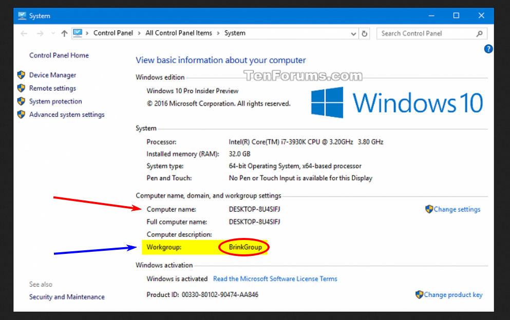

        So, all three of your computers need to have a unique *Computer name*, but they all have to share the same *Workgroup* name:
        Win10-System-Page
        If I understand Bandit233’s comment, even though his computers still shared the same *Workgroup* name, somehow the Win10 Update changed two of his computers so they no longer had access to his previously working network. By running the elevated command that’s outlined in *Option 2* on those two computers, and using the *same* Workgroup name as used previously, it re-set the network relationships so those two computers were successfully re-joined to a functioning status on the network.
        Now, your problem may not have occurred after a Win10 Update–could have been some other glitch that occurred. But the problem sounds to be the same regardless of how it happened.
        Worth a try to see if this resolves your problem.

        Yes, apparently *Option 3* does not work!
        But until you actually do exactly what Bandit233 has reported worked (*Option 2*), I would have to say you do not know if that will also fix your problem.
        I suppose I could try to create a new workgroup with a different name and then add all 3 PCs to the group, but that might affect the printing on the other laptop.
        You certainly could try that–basically *starting over*. But just about anything you do has the potential of knocking out the current networking relationships that you may have to re-establish. But, I think accessing a shared printer only requires being able to *see* the computer on the network (i.e. the computer’s unique name), and the assigned name of the printer. If your current *working* laptop continues to be a part of the network after a name change, then, if needed, re-establishing the printer sharing should go without a problem.
        But, I would still try *Option 2* first. It has no negative side effects that I can see, except it may not work!

        Tried option 2, but that did not make the Desktop PC visible from the problem laptop. Oddly enough, the other laptop is visible from the problem laptop, but not the Desktop (or the shared printer)
      • #1989050 Reply
        Guest
        And in response to PKCano, I have been able to print from the problem Laptop in the past, but something has changed and neither the Desktop nor the shared printer is visible from the problem laptop – although the other laptop (from which I can print) is visible from the problem laptop.
        So
        the Desktop can see both Laptops
        one Laptop can see the Desktop and the shared printer (and print)
        the other (problem) Laptop can see the other Laptop, but not the Desktop or the shared printer.
        all the PCs say they are part of WORKGROUP, and I’ve joined both the problem Laptop and the Desktop to WORKGROUP using the command line solutions suggested in another message.
        At this point it “feels as if” the firewall on the Desktop is not allowing connections to the problem Laptop. but that is just a conjecture. I can ping the Desktop from the problem Laptop, but can’t see it in File Explorer.
