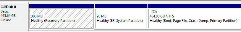

Zig
AskWoody PlusPaul,
Upgrade is done (successfully).
Now the issue (if any) is repair (if necessary) of the EFI partiton.
Disk Management shows may partitions, some probably superfluous from old MBR installations. I BELIEVE all I need is:
System
Recovery
EFI.
?Correct?
See attached for the current state of affairs foe my Boot disk. Note the 4 Recovery partitions.
As before, any help is appreciated.Zig (off to bed)
January 13, 2021 at 2:42 am #2333621
Paul T
AskWoody MVPStrictly speaking, you only need EFI and system partitions, and the EFI partition can probably be removed if you never use Bitlocker.
You have 3 options as I see it.
- Do nothing. Almost no disk space is lost.
- Delete all partitions after C: and add the free space to C:.
- In addition to 2 above, remove the first recovery partition and move everything to the beginning of the disk (using MiniTool Partition Wizard free). This is the most risky and might be better achieved by clearing the disk and restoring partitions 2 and 3 from backup.
