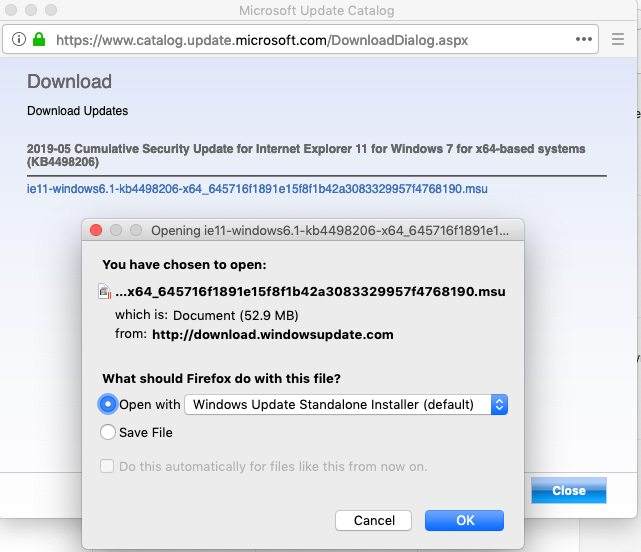

AskWoody PlusYet again the file hashes for the cumulative security update for IE11 (KB4498206) do not match the table of hashes here. I know it’s in the filename but it’s a bit disconcerting when there’s a mismatch like that and filenames can easily be changed. Probably give the May update a miss since it’s cumulative anyway.
June 2, 2019 at 3:47 pm #1766176
Manager-
June 2, 2019 at 5:01 pm #1766299
T
AskWoody PlusYes but that’s the filename, if you look at the table (under ‘File information’) in the link to the cumulative update i posted that hash in the filename doesn’t match any of the SHA1 hashes listed. Nor does SHA256 if you check the file from a command prompt using certutil -hashfile. This happened in january as well and i skipped that update. I’m sure it’s safe but you know, it’s microsoft we’re talking about here and since they are cumulative i’d rather just skip an update. I’m group b by the way.
This reply was modified 1 year, 7 months ago by
T.

L95
AskWoody PlusPK: I have 32-bit Windows 7 and have paid for ESUs, and I just tried downloading the 32-bit November 2020 updates by clicking on the links in your AKB 2000003 article, but I got messages (for both Windows 7 and IE11) “can’t be downloaded securely”. It also gave me a button to click on called “Keep”, and so I clicked on that, and then they downloaded. I’m afraid that when I clicked on the “Keep” button, I may have done something that would make my computer insecure. What should I do? I’ve never had any problems like this in previous months. I will appreciate your response.
November 28, 2020 at 7:48 pm #2315578

November 28, 2020 at 8:57 pm #2315590
L95
AskWoody PlusPK: Windows Updates has never offered me Security-only updates. Instead, it offers me the monthly rollup, which I then un-check. In fact, when I went to Windows updates right now, that’s what it’s offering me is the monthly rollup. Have I been doing something wrong? I’ve simply been following the procedures in your AKB 2000003, because that was the procedure I used prior to subscribing to the SSUs, and I didn’t know I was supposed to change once I subscribed to the SSUs. And it’s worked so far. I haven’t had any problems up until now. If I’m supposed to use Windows Updates, how do I get it to show the security-only updates instead of the monthly rollups?
Also, what should I do now that I clicked the icon “Keep” , as I described above. Have I made my computer insecure by clicking on “Keep”? Should I delete those files that I downloaded?
I appreciate your help, and will appreciate your response.
November 29, 2020 at 4:18 am #2315642
ManagerThe files are no more insecure than if you downloaded directly from the MS Catalog because the files ARE a direct download from the MS Catalog. If you go the to MS Catalog you will get/see the same thing. Your computer IS NOT insecure.
The download has nothing to do with AskWoody except that the link is displayed here. When you use the link, you are downloading directly from the Microsoft Catalog.-

L95
AskWoody PlusPK: Thanks for your response. Actually, I already knew (before I made my original posting on November 28th) that the downloads were coming from the Microsoft Catalog. If my posting somehow made you think that I thought they were coming from somewhere else, then I apologize. What my message did say was that I had gotten a message that said that the file “can’t be downloaded securely”. And so that language made me think that perhaps my computer was made insecure because I decided to click on the “Keep” button, which caused the file to be downloaded anyway. And since you folks have more knowledge about computers and security than I do, I had thought I would ask you about it, and so that’s why I made my posting of November 28th . In any event, now I’ve gone ahead and installed the file after downloading it because your response says the download did not make my computer insecure. But afterwards I did some more experimenting with a different browser. It appears that the “can’t be downloaded securely” appears only if I use the Chrome browser, but does not appear if I use the Firefox browser. When I use the Firefox browser, it downloads just fine without any message appearing. I’ve always used the Chrome browser in the past and never got this message until November 28th, so it must be something new within the Chrome browser. Anyway, the file that I installed was the one that I had downloaded using the Chrome browser, because I didn’t think of trying the experiment with Firefox until afterwards. So do you think my computer is secure with the installation of the file that I downloaded using the Chrome browser? I assume your answer will be “yes’, but I just thought I’d check with you to be sure, and also this lets you know that my experimenting with a different browser led to a different result.
December 1, 2020 at 1:19 am #2316179
Paul T
AskWoody MVPI’m afraid that when I clicked on the “Keep” button, I may have done something that would make my computer insecure
If you try to download the same/other updates do you still get that message?
Can you post more details of the message?cheers, Paul
December 1, 2020 at 12:29 pm #2316286
L95
AskWoody PlusThanks. I tried your suggestion of downloading a different update, namely KB4577053, which I had downloaded successfully in the past (on October 3, 2020), and this time it did NOT download successfully, indicating that there’s been some change since then. You asked about more details about the message, so hear they are: it appeared in the lower left-hand corner of the download window and it said “Windows6.1-kb45….msu can’t be downloaded securely” . Just to the right of that, there is a button called “Keep” that you can click on to get it to download.
I will appreciate any suggestions /comments you may have.

AskWoody PlusPaul T: There are actually two different screenshots, depending on whether I go directly to the Microsoft catalog or whether I use the link on the askwoody.com website. If I go directly to the Microsoft catalog, it looks like in the attachment to this posting. (I put it into an attachment because I wasn’t able to figure out a way to paste it into the body of this posting). The second screenshot (which I haven’t included here) is one taken when I used the link in the askwoody.com website to download, and in that case it showed up in the Chrome browser window. It looks pretty much the same as the attachment which I’ve included in this posting, except that the wording appears in the lower-left corner of the Chrome browser Window.
I will appreciate your comments and advice.
December 3, 2020 at 3:41 am #2316775
December 3, 2020 at 3:49 am #2316776
Paul T
AskWoody MVPThe message is from your browser and is not an indication of anything other than MS using http instead of https. See example below. Your browser is providing FUD in the name of
marketingsecurity.cheers, Paul
http://download.windowsupdate.com/d/msdownload/update/software/secu/2020/10/windows6.1-kb4578952-x64_30ac0df8554c2647017f3b36cc02e833a3187364.msu
December 3, 2020 at 11:50 am #2316851
L95
AskWoody PlusPaul T: Thanks for your response. I was able to download the example you provided without getting the message “can’t be downloaded securely”. It appears that the reason is that there is no “s” after the “http”. When I went to the catalog in the situations I described above, I think I went to an “https” web address, because that’s what was provided to me by a Google search for the term “KB4577053”. So here are a couple questions: (1) how did you end up getting to go to an “http” site instead? (2) What do you recommend I do in the future? If I get the message “can’t be downloaded securely”, should I just click on the “Keep” button?
December 3, 2020 at 12:21 pm #2316864
HiFlyer
AskWoody PlusYou can get a browser add-on for Firefox, Chrome and Opera from The Electronic Frontier Foundation
https://www.eff.org/https-everywhere
That stops you from accidentally going to an insecure (http) site. You can override it if you want to.
EFF also offers Privacy Badger.
Cheers, HF
December 4, 2020 at 1:53 pm #2317185
December 4, 2020 at 12:45 am #2317037
Paul T
AskWoody MVPWhat do you recommend I do in the future?
Downloading updates from MS is fine whichever way you do it. Don’t worry too much about it.
