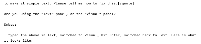

      I do not know why this forum app is double spacing every time I hit enter at the end of a sentence or why it has selected this font it is using now. I have no clue how to make it simple text. Please tell me how to fix this.
      Are you using the “Text” panel, or the “Visual” panel?
      I typed the above in Text, switched to Visual, hit Enter, switched back to Text. Here is what it looks like:
      VisualText
      I don’t think that one can change the font of direct text entry.
      Cumbersome Workaround –
      If one must have another font, create the entry (in Notepad?), do a screenshot, manipulate/crop it, Save As it, and Attach it here (Select File).
