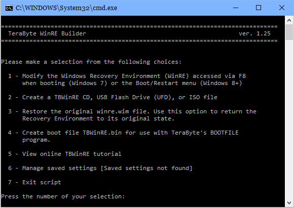

    I’ve highlighted the script that does the magic.  Right-click TBWinRE.cmd, select Run as administrator, and you will see this Command window:
    TBWinREBuilder
    Go ahead and plug in your thumbdrive or insert your CD/DVD, and press “2” on your keyboard.  The script will begin, first searching for “winre.wim” on your PC, which is usually in the MSR partition directly behind your Windows partition.

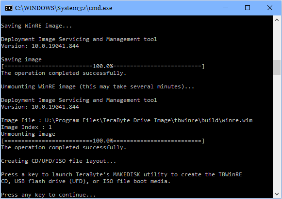

    Once it has found winre.wim, it will save a pristine copy of that file, use the DISM tool to perform some machinations to that file, unmount the image files that it has mounted, and then ask you to continue.
    TBWinREContinue
    Press a key to continue, and you’ll be presented with the MakeDisk utility.  Click the Next button.

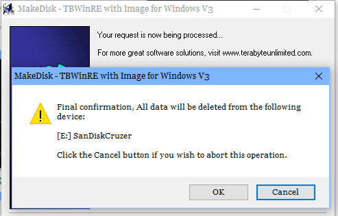

    If you have chosen a thumbdrive, you’ll be warned.  Click the OK button if you’re OK.
    TBWinREContinue5
    TeraByte wants you to be sure you’ve made the correct decision.  If so, click OK again.
    TBWinREContinue6
