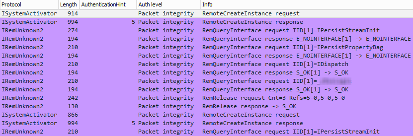

Coming back to this. I may have figured it out for my case.
I discovered that if you run Wireshark on the server, you can filter on “dcom” and see the Auth level requested and in use. I’ve added AuthenticationHint and Auth level as columns (isystemactivator.properties,scmresp.authhint and dcercp.authlevel, respectively). Here we see “Packet integrity” is in use, but only on the initial connection (in the RemoteCreateInstance requests and responses):
Per this reference that AuthenticationHint=2 corresponds to RPC_C_AUTHN_LEVEL_CONNECT. So I’m requesting Connect and getting Packet Integrity, but only during the initial connection.
After increasing my DCOM proxy on the client to specify Packet Integrity, the AuthenticationHint increases to 5 (RPC_C_AUTHN_LEVEL_PKT_INTEGRITY). More importantly, all the packets carry that Auth level = Packet integrity. So that is apparently what Packet integrity means, that every single packet has authentication info.
The thing that still seems odd to me is that even with the server set to enforce RequireIntegrityActivationAuthenticationLevel, it still wasn’t complaining (raising errors) when Auth level was set to Connect–maybe because that connection uses Packet integrity? I guess I could try setting the Authentication level to None to see if it would fail.
