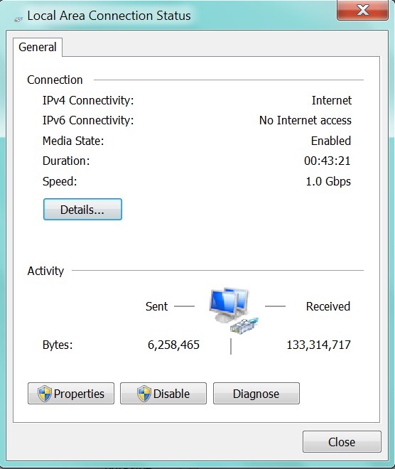

      Is that the same PC where you ran the test in Ubuntu?
      What speed is the network card connected at? Check on the old and new router.

          In Windows (bootup) if you check your network cards status, does it show that you’re connected on the physical Ethernet cable at 100 or 1000 and is it half duplex or full duplex?
          This is starting to look like a driver or driver settings issue.
          I understand it’s the same hardware, on the same physical connection using dual boot.

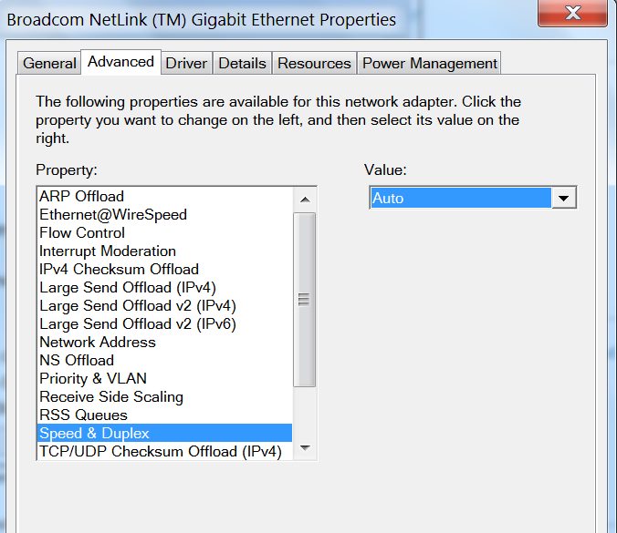

      My NIC is an older on the MB variety.  I am posting the settings.  You can see from the device identified in the title bar that it is a Gigabit ethernet adapter.  The driver is old, and I am unable to update it (I tried earlier this year) and was told that I have the best drive.  I used a driver from Broadcoms web site.  I do not see a setting for QOS listed in the settings.  I saw in one of the NETSH screens that it was running at 1000.
      When I went into admin account and changed the IPV4 servers to the Google ones, I did get a speed reading of >220.  I have not been able to reproduce that since while in Windows.

    • #2278455
      In Network and Sharing Centre click on the ethernet link to show the status – see attached.
      Capture

      • #2278551
        Type this in a PowerShell window: netsh int ipv4 show subinterface
        In the NIC Properties you should see these values.
        Flow Control: Tx & Rx enabled
        Jumbo Frame: Disabled
        Receive Buffers: 512 (may be different to mine)
        Speed & Duplex: Auto negotiate
        Transmit Buffers: 128 (ditto)
        I do not hace3 of the settings you listed.  The 2 I have are already set to the values you stated.  I posted screenshots of all of my NIC properties earlier in the thread.
