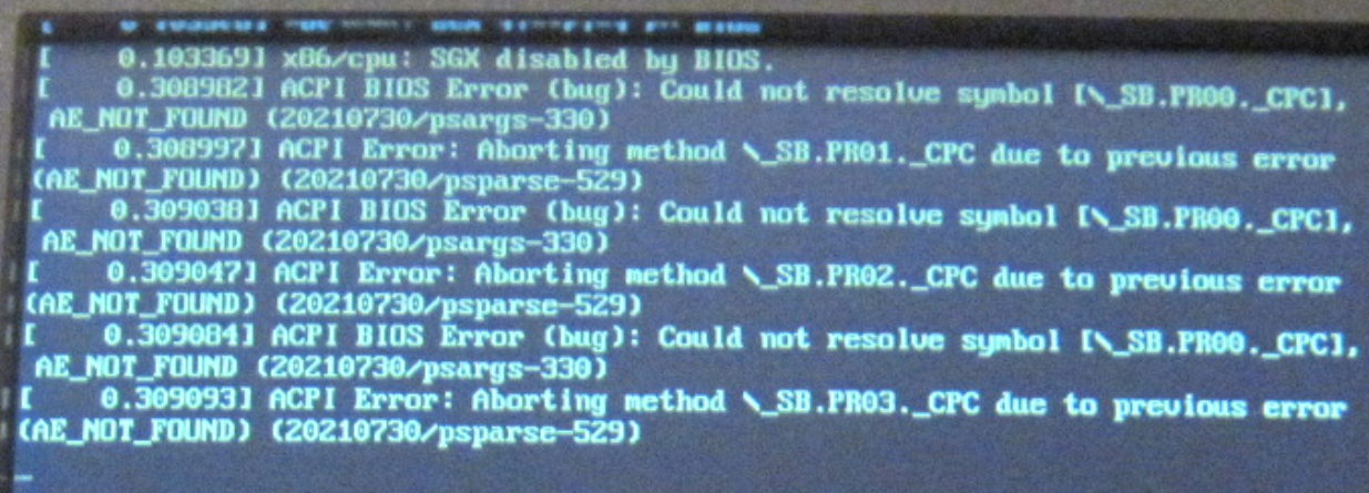

      Re Print Screen/Clipboard- Faced with diverging opinions here and elsewhere, went with stone-age tactic, photos of screen.  Same text appears twice during boot sequence.  No idea what it means.
      1st-error-s-shot
      2nd-error-s-shot
      This machine is Dell refurbished; official reply is CMOS battery is not replaced during refurb.  Unknown whether a possibly weak battery might be at the bottom of this issue, but not hard to test/replace.

      According to your screenshot, the first thing listed is SGX disabled by BIOS. If you google that, it shows that SGX= Intel Software Guard Extensions. There are many post’s from all different brands of computers with that problem such as this one https://techlibrary.hpe.com/docs/iss/proliant_uefi/UEFI_Edgeline_103117/GUID-5B0A4E24-26B7-46CC-8A12-5C403A14B466.html
      Don’t know if that’s your complete problem but it’s a place to start if the cmos batt. isn’t at fault. Hope this helps.

      As I suspected before your screenshots, not a battery issue….
      The SGX report is related to intel ‘Software Guard Extension’ at BIOS level, which is ignored in the LM kernels modules and this is only a screen report not an error.
      To overcome the annoyance, see this LM Forum Thread and pay particular attention to the second post on how to make the report disappear, or just leave it as is, your choice, it’s just info anyway.

      Good to know that the system is not alerting me that it’s about to dissolve into a smoking pile or suchlike.
      In order to read this text, I had to carefully time a photograph, as the text appears very briefly.  Couldn’t tell that it is the same repetitive line.  Even if I enable the Print Screen function, the boot process may or may not be far enough along to activate it.  Going forward, is there a means to freeze something like this in order to read it?  Perhaps next time the info will be more consequential.
