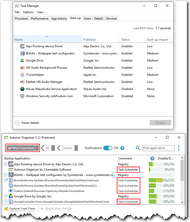

AskWoody_MVPDoes Autorun Analyzer find any programs that load at startup, which don’t show up when you load Task Manager, and choose Startup tab? Or does Autorun Analyzer simply duplicate the list of startup programs that you find when you use Task Manager?
Autorun Organizer is more granular than just duplicating Task Manager‘s Start-up tab results.
For example, even Autorun Organizer‘s default setting of ‘Most Important’ includes tasks in Task Scheduler (including those that are disabled):

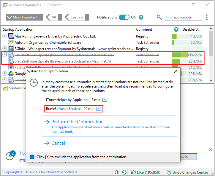

Two things to note:
1. Autorun Organizer suggested an optimisation of a startup item (BraveSoftware Updater), even though it was disabled:
