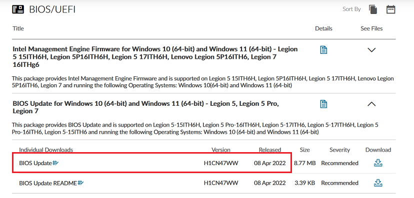

Hi Mike:
Your link in your post # 2440671 suggests you have a Lenovo Legion 7-16ITHg6 laptop. If that is correct, what is your Windows operating system and current BIOS version? If you aren’t sure what BIOS version you have open a Run dialog box (Windows key + R), enter msinfo32 to open your System Information panel (or just search from your taskbar for “System Information”) and look for the “BIOS Version/Date” field.
The table at the bottom of the Lenovo Security Advisory LEN-73440 (Lenovo Notebook BIOS Vulnerabilities) states that users should “Update system firmware to the version (or newer) indicated for your model in the Product Impact section” and the table at the bottom of that security advisory shows that all three vulnerabilities (CVE-2021-3970, CVE-2021-3971 and CVE-2021-3972) are patched by BIOS firmware version H1CN46WW or newer for the Legion 7-16ITHg6.
If you click the link for the Legion 7-16ITHg6 in that table it takes you to Drivers & Software page <here> for that specific model. Filtering for BIOS/UEFI components (2 downloads available) shows that the recommended BIOS firmware is version H1CN47WW (rel. 08-Apr-2022). I don’t own a Lenovo laptop, but I assume that means if you have either the previous BIOS version H1CN46WW or current BIOS version H1CN47WW that you are already patched against these vulnerabilities.
If you have the recommended BIOS version H1CN47WW (rel. 08-Apr-2022) then it would make sense to update to the recommended Intel Management Engine Firmware version H1ME46WW (rel. 08-Apr-2022) as well to keep pace with your BIOS version, but in this case I don’t think that the recommended Intel Management Engine Firmware update is actually required for patching CVE-2021-3970, CVE-2021-3971 and CVE-2021-3972.

Do I update both the Bios and Intel Management Engine Firmware or just bios?
Yes. Update both.
If your laptop has a BIOS export you should create a backup file just to be able to restore in case something go wrong.
Don’t use Lenovo Vantage for updates. Download and install manually.
