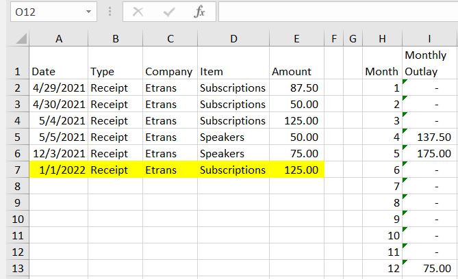

      Ok, here’s one w/o a helper column:
      =SUMIFS(E:E,A:A,”>=”&$H2&”/1/2021″,A:A,”<"&$H3&"/1/2021") The only caveat here is that you'll have to adjust the December formula after you do the fill down. =SUMIFS(E:E,A:A,">=”&$H13&”/1/2021″,A:A,“<1/1/2022")
      Update:
      Using EDate as shown by BTBS below you can eliminate the need for editing the final formula, e.g. =SUMIFS(E:E,A:A,”>=”&$H2&”/1/2021″,A:A,”<"&EDATE($H2&"/1/2021",1))
      Sample:
      NoHelperColumn
      Note: the highlighted line is not included!
      HTH
