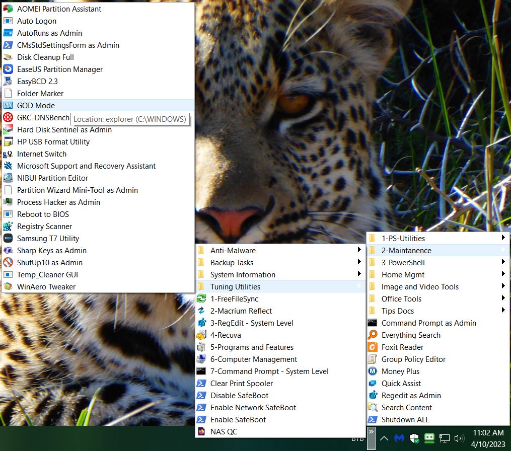

      I’ll apologize for this long post now. Rather than post a bunch of disconnected paragraphs I just copied Susan’s post and annotated in bold where I did something differently. Please note these are just MY OPINIONS!

      Don’t worry about this as I don’t connect it to the internet until I have the basic setup completed. Yep, setting up a LOCAL account. The above is step 1b. Step 1a is inserting a USB Macrium Reflect Boot disk and USB Storage (HDD or SSD) drive before I turn it on and then booting using Reflect to take a full image BEFORE it is setup. Makes it much easier to return the device if necessary or even when passing it on to someone else down the road.
      While you’re at it after deleting the trial stuff, and making sure you have COMPLETELY removed it, check Windows Defender’s settings. Especially, running it in the SandBox and checking for PUPs (potentially unwanted programs)
      A big fan of StartAllBack (paid) or Open Shell (free). In conjunction with those I also set up a toolbar in the Notification Area to give me access to all my most used stuff (it’s a lot!)
      BEKTBImage
      I’m still not connected to the internet. Load the GRC tool from a USB Stick, or use GPO if running PRO. Also set Windows update to Pause updates for 28 days!
      At this point I also take steps to remove Documents, Videos, Music, Downloads, etc. to a different drive (In my case a physical one) partition which I always label G, a holdover from the setups in my working days). This is done with the Location tab on the folder properties in File Explorer.
      I’d recommend another Image backup at this point. Now you can safely connect to the internet.
