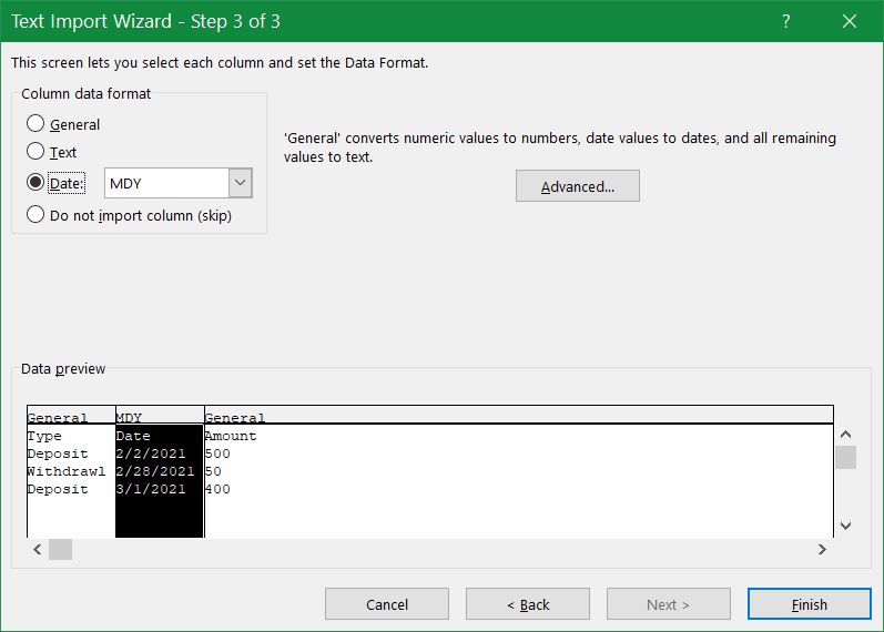

    • #2352830
      Ron,
      You need to use the Import Wizard to get what you want.
      File->Open
      Select Your file (you need to change the type selector box to .csv)
      The wizard should popup.
      TextImportWizard
      On this screen you need to tell the wizard if your file has headers or not. (Default = No Headers)
      Click Next
      DelimiterSelection
      Now you need to select the data delimiter, usually a comma. (Default = Tab)
      Note: I should have unselected Tab but it didn’t make a difference in this case!
      Click Next
      SpecifyDateFormat
      On this screen click on your Date field at the bottom.
      Click the Date radio button and select the format the dates are in.
      Repeat for any other date fields.
      Click Finish
      ImportedDates
      You can see it imported the dates and it knows they are dates. Just select them and right click and select Format Cells and you’ll see they come up as dates!
      FormatDialog
      Here you can change the format to other locals by selecting the Locale (location): dropdown.
      DatesReformatted
      HTH 😎

    • #2353964
      RetiredGeek, thanks for the very detailed explanation, it is greatly appreciated.  It has taken me a while to return to this as I have to deal with some things in my personal life.
      I hope you don’t mind, I printed your reply out as a Word document so that I could have it for future reference.
      I am using Excel 365 which, unfortunately does not have the Import Wizard.  I searched around and found that it can be invoked as a legacy application.  Once I did that, then everything else was straight forward.  All worked, as it was a simple matter of importing as a Table in Excel.  The Table will work as I would have had to convert it to that anyway as most of my ongoing analysis is with Pivot Tables which are better implemented from a data table within Excel.

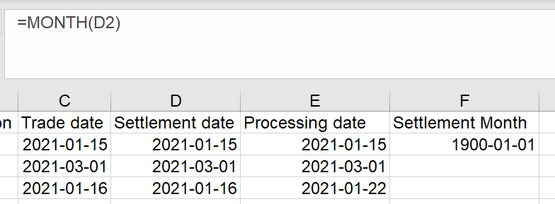

    • #2356647
      Paul, thanks for the Snip & Sketch reference. I usually use the Snipping Tool, but the end result is the same, I guess.
      Retired Geek, I thought I would keep this in the same thread as I suspect that they are related.
      I imported the CSV file following your previous instructions and converted it to an xlsx file.  I need the MONTH from the “Settlement Date” , so I set out to use the MONTH function, only to be surprised by the results.Screenshot-2021-04-11-084639
      It calculated the first date of Excel – 1900-01-01 as the MONTH.  Obviously, there is something not working right because if I check on the format of the “Settlement Date”, it is in a Date format.  Any insight into how I can extract the Month from the converted date?
      Ron
      • #2356827
        You set “Settlement Month” cell format as date. Thats not going to work.
        Set it as “general” (or number). Then the months will be displayed correctly.
        I used the MONTH function to extract date from a cell on the left.
        You should see the difference in two cells on the right of the picture. Hope this helps.

    • #2356836
      doriel, thank you for the solution.  I must confess to being a bit puzzled though as a Month is part of a Date and, I would think should conform to a Date format.  Regardless, setting as General works.
      Hopefully, I am now finished with the peculiarities of converting a .csv file to an .xlsx file.
      Ron M
      • This reply was modified 2 years, 5 months ago by Ron M.
