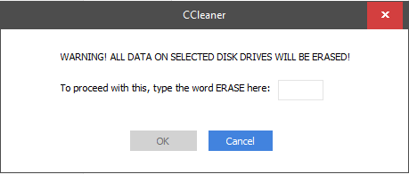

          Rick Corbett
          Calimanco, I finally got a chance to D/L DBAN. But when I went to the website, it says DBAN is for hard drives only. Is there something similar that works for external USB drives?
          DBAN doesn’t support USB-to-ATAPI connections, only direct bus connections like PATA (i.e. IDE), SATA or SCSCI.
          Have you looked at CCleaner‘s Disk Wiper?
          1. Run CCleaner as Administrator.
          2. Click on Tools in the left-hand pane.
          3. Using the Wipe dropdown, change this to Entire drive.
          4. Using the Security dropdown, select the number of overwrites. (I suggest 3. See this article for more info, including a list of disk wipe utils.)
          5. In the Drives list, select the USB drive so the Wipe button becomes active.
          6. Click on the Wipe button.
          46997-ccleaner-disk-wipe
          Click to enlarge
          7. Type erase (it’s not case-sensitive) to activate the OK button on the confirmation dialog that appears:
          46998-ccleaner-disk-wipe-confirm
          Click to enlarge
          8. Click on the OK button and sit back. Be aware that the process is painfully slow…
