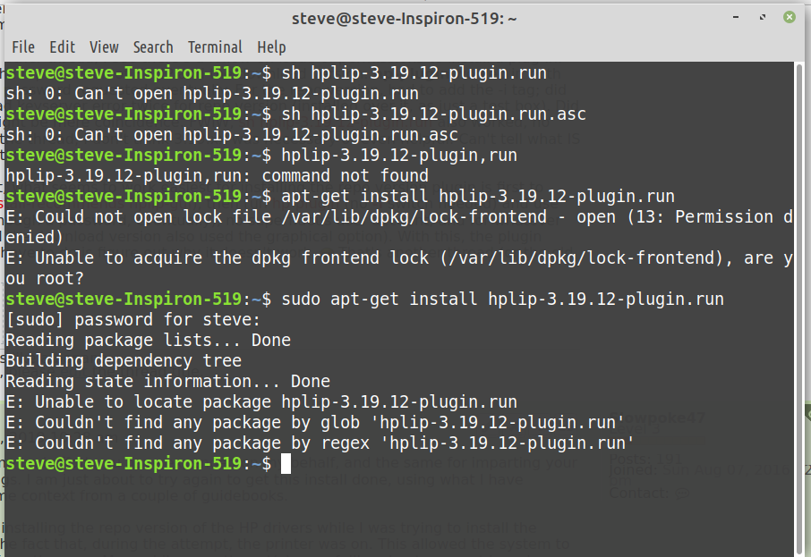

      Slowpoke47

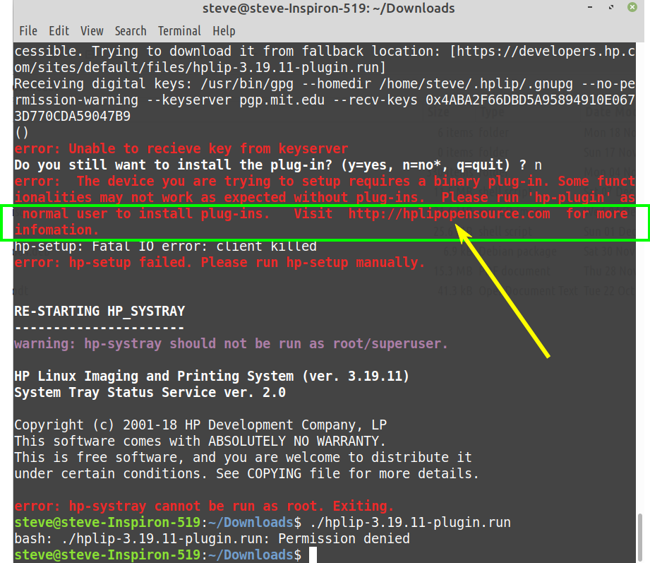

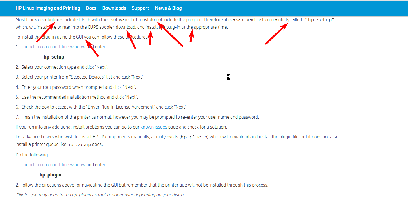

      As a newcomer to Mint (and a “never 10″ user), I’m finding a lot to like, even as I occasionally struggle to get fully up and running.  Mint automatically found our network HP LaserJet M1522nf multifunction printer and installed the printer driver from the repository, but a plugin is needed, per the HP site, to enable scanning for this model.  There are instructions on the site to do this:
      HP-printer-plugin

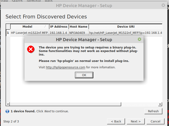

      However, when executing the Terminal commands, the result was:
      Terminal-re-plugin
      This page on the HP site has a 10 year old date, so the stated sequence apparently is obsolete.  Anyone have a suggestion?

        Thanks for the suggestions.  hp-se (tab) goes nowhere.  (enter) from there shows command not found.
        hplip-data not found in search of package manager.
        Scan function not enabled.

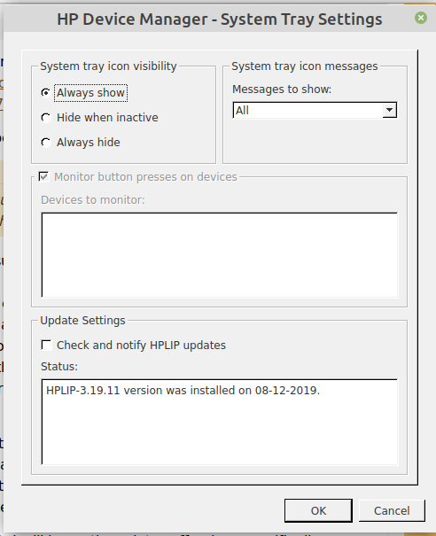

        Most recent printer driver is v.3.19.11, per HP site.  But, also per HP, the version currently installed should support scanning with the plugin added.

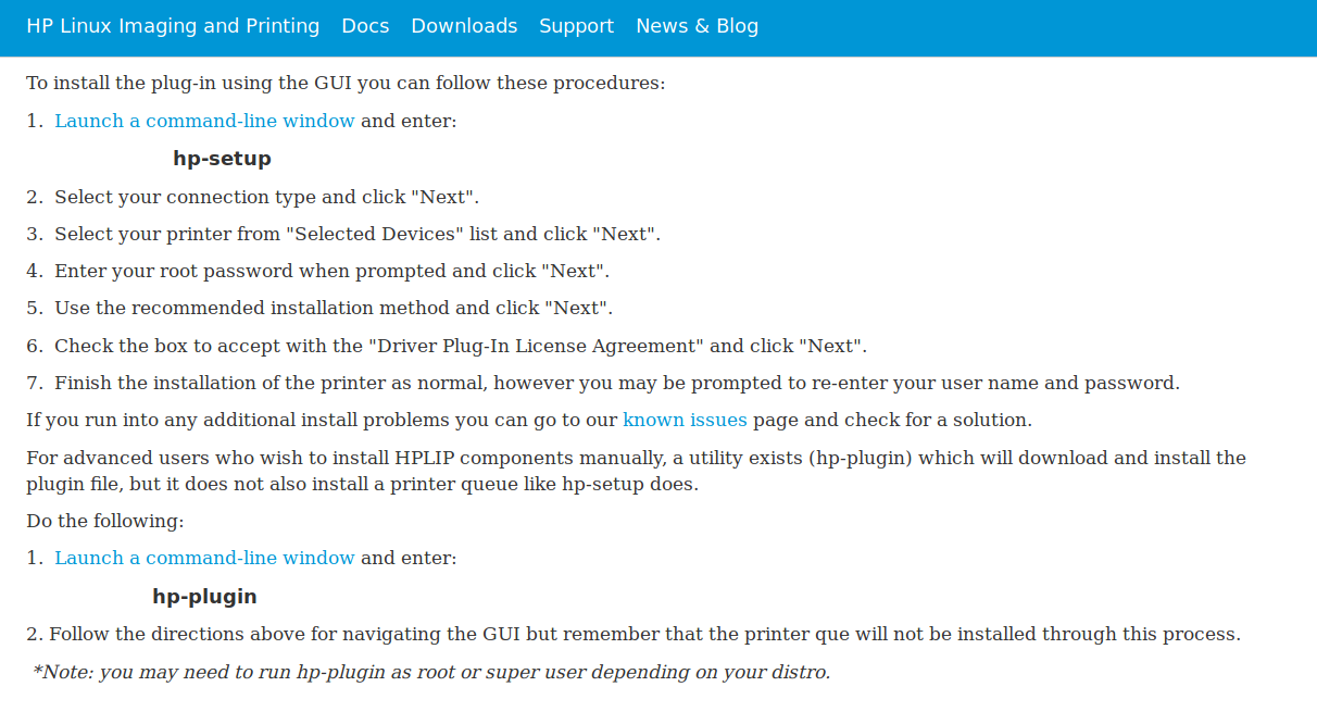

      Perhaps someone with a greater level of understanding than mine could look at this link, which refers to plugins and installation options, and offer some wisdom…
      https://developers.hp.com/hp-linux-imaging-and-printing/KnowledgeBase/Class_Driver

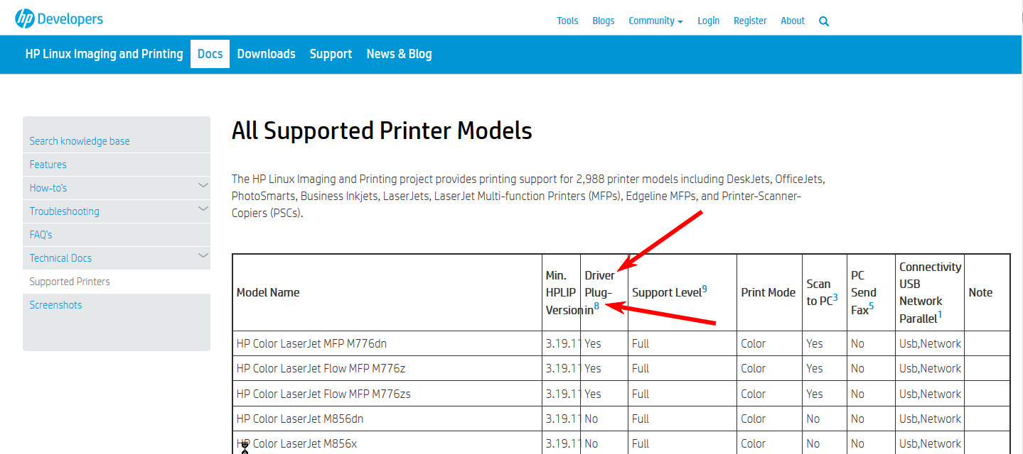

    • #2013316 Reply
      Slowpoke47
      our printer is on the list of machines that require another plugin for scanning to work.
      Possibly if I can get that most recent file installed, the scan element will have been baked in and the plug in won’t be necessary.  Wishful thinking?

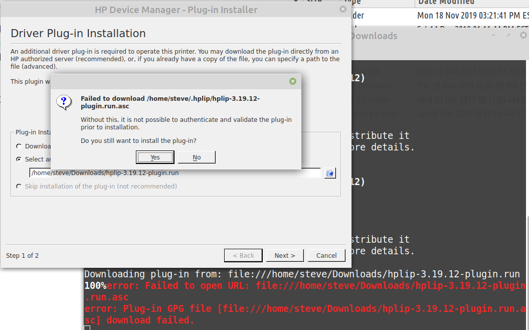

      Just today downloaded and installed the current driver.  All good until the error message, plugin needed.  Tried several ways to get it, no joy.
      Screenshot-at-2019-12-01-10-45-09
      plug-in-install-failed
      Eventually brought to “Ubuntu one” where I had to create an account and then ask a question re the missing plugin.  Several others have the same issue there.
      • #2013355 Reply
        Ascaris
        This might help.  I got it from one of the posts at Ubuntu, and some other people reported it worked.  Copy and paste these lines in one by one.  It’s not good to get in the habit of just entering commands you don’t understand, so here’s what they do.
        The first line installs Apparmor Utilities from the Ubuntu repo, which lets you have some control over the Apparmor feature that is part of Ubuntu and its descendants (like Mint).  Apparmor is a security feature, but when it gets in the way, it has to be turned off.
        The second one disables it for the plugin installer.  The third is probably the line you used already to run the installer, which hopefully will now work.
        sudo apt-get install apparmor-utils
        sudo aa-disable /usr/share/hplip/plugin.py
        hplip-plgin

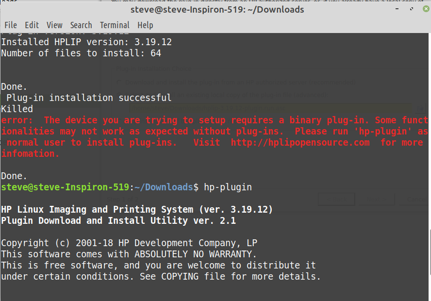

        Use hp-plugin as the correct command.

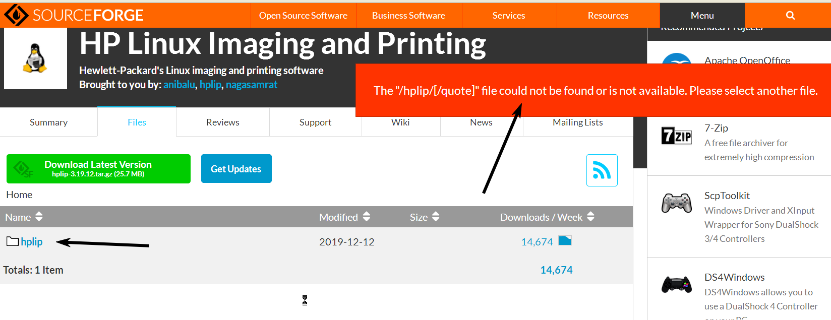

      This link to the HP site lists plugins by driver version:
      https://developers.hp.com/hp-linux-imaging-and-printing/plugins
      But there’s a snag- see above posts, in spite of my efforts to the contrary, the system reloaded v.3.17.10, the version included in the repository, and the list on this link goes only to v.3.17.11.  And if it seems ok to use that plugin, there are two items shown, one with .asc and one without.  Which one?

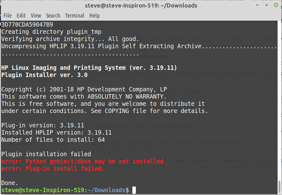

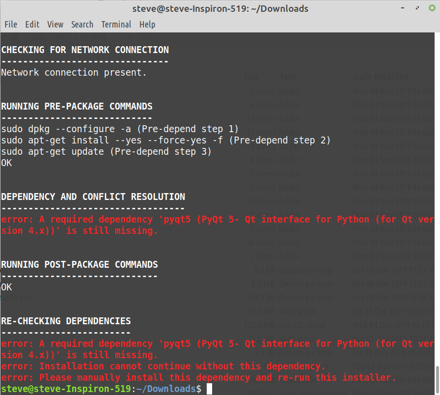

      Downloaded most recent drivers from HP site.  Didn’t know how to format the terminal command, so tried the double-click method directly on the downloaded file.  This process took quite a while, and when finished, generated this error message:HP-printer-drivers
      So, still stuck on this.
    • #2014297 Reply
      Slowpoke47
      One of the posters in the thread I saw about this issue said that he got it to work by installing the 3.17.10 version from the Ubuntu repo, which Mint also uses, and the 3.17.11 plugin from HP, but he had to rename the plugin to 3.17.10 (whatever format the filename had, he changed that 1 to a 0), and it worked.
      Just now tried this workaround, saw the same error message as in my last post.
      At this point, looks like we’ll have to keep Win7 in both computers to have the scan function enabled- works as expected in that OS.

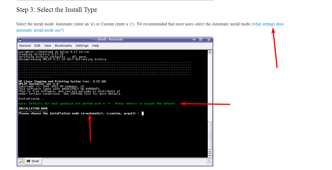

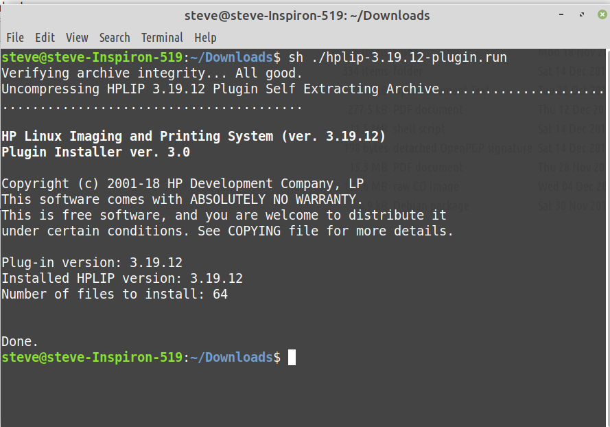

        The terminal command you will need is probably
        sudo sh ./hplip-3.19.11.run
        from the directory where the file is stored.

      Attempted newest driver install via terminal using Ascaris’ detailed guide:
      HP all-in-one printer in Mint
      Newest driver is v.3.19.11.  Repository had 3.17.10, auto-installed during Mint install.  During today’s installation, terminal text generated, 3.19.11 exists, may interfere with this installation, ok to remove?  I responded yes.
      From there, process seemed ok until error message re plugin, which system automatically looked for.  See screenshot:
      Plugin-error
      Note that system would not let me install plugin manually as su, so I tried to do it as reg. user- “permission denied.”
      Looked in Pkg Mgr for hplip entries- shows old version installed, no returns when looking for new version.
      I’d be ok with using the old version, except there is no plugin offered for that driver file, and the plugin is needed to enable scanning.  So, end result is no change from status quo- printing works, scan function AWOL.  Previously tried removing the old version as shown in the repository before trying the new install, but the result was the same- old version reinstalled, no scan function available.

      The HP site offers “advanced” methods to install the driver software:
      https://developers.hp.com/hp-linux-imaging-and-printing/KnowledgeBase/Class_Driver#_Toc499306388
      These methods call for the removal of any existing hplip drivers, then the installation of, in this case, an “older new version” of the driver file.  This version does have a companion plugin offered elsewhere on the site, but there is no reason to think, since the process is in fact the same one I used (previous post) that the outcome would not be the same.

      A possible theory about the old vs. new driver problem:
      I am not really sure about what happened with it replacing the one you installed with its own.
      The Mint system is supposed to find printers that are connected to it and automatically install the driver from the repository.  In this case, the repo has a   substantially outdated version.  Meanwhile, I’m trying to install the newest version, an effort that has not completed several times.  But each time, an HP icon appears in the tray, which, when right-clicked, produces a pop-up that, among other text, tells me that the 3.19.11 driver I have been trying to install, is in fact, installed.  Pkg Mgr does not show this software.  Conclusion- that program is partially installed.  Notice the install date shown, from my first effort-
      HP-Device-Manager
      I think the two events may not be related.  When the repo version of the driver is uninstalled and the printer then turned on, the system automatically re-installs it.  But my attempts to install the new version have never completed, so it is MIA in Pkg Mgr.
      For my next attempt, I will leave the printer off unless specifically directed otherwise by the terminal.  Perhaps this will prevent Pkg Mgr from re-installing the old driver.

      Several attempts, still no joy… Removed old printer drivers.  Printer turned off. Downloaded and tried to install the files from post #2016087 above.   Here’s the result:
      libsane-hplip
      This seems to be a dead end.
      Then tried again with the hplip-3.19.11 downloads, driver plus plugin- the system ran me around in a circle- would not install the driver without the plugin, and wouldn’t install the plugin without the driver:
      error-message
      Also tried custom 3.19.11 install instead of automatic, with option to choose installed elements- specifically did not select enabling scan function- system still called for the same dependency as before.
      I’m re-posting this link in case someone can tell me whether there is a workaround on this page-  hp’s Developer Portal | Class Driver guide for Advanced HPLIP Users
      At this point, I’m stuck.  But the HP tray icon is still there, see above post, even though the HP software is supposedly removed.  Also, the Downloads folder now has two screens’ worth of new entries resulting from my efforts today.

        The .deb files don’t use the sh command.  Just launch them with the file manager by double clicking them, and Mint should launch them in the Gdebi package installer.  If you wanted to run those on the command line, you could try the same command, except with ‘gdebi’ in place of the sh.
        The .tar.gz files are tarballs.  It’s like a .zip file… if you double click those in the file manager, it should launch whatever archive program Mint uses by default, and you can then extract them to wherever you wish.  I don’t know what program that is, but you should be able to use the command line version too if you like once you know the name of it.
        Edit: The pyQt5 package should be in the Ubuntu repo.  Generally, it’s better to get things from the official repo if you can, and install them from an external source only if the package you need is not there, or if the official one is too old.  The question is which one exactly is needed, as there are several!  I am guessing it’s python-pyqt5, which you can install using Synaptic graphically, or
        sudo apt install python-pyqt5
        from the command line.

      Followup- currently, repo drivers re-installed.  Error message in terminal names PyQt5 as the missing dependency.  Online search found PyQt5_gpl-5.6.tar.gz which I downloaded and tried to install.  Attempt failed, but perhaps there is a clue here.
      Plugin-error-1
      • #2016664 Reply
        I don’t have a lot of experience extracting archived files in Linux, so I’m not sure if it’s applicable in your case, but you might be able to extract (unzip) that archived file by navigating your Mint file manager to the directory where the archive file is located and double-clicking on the file, the same way as you might do it in Windows. If that doesn’t do it, you might try right-clicking on the filename and see if you’re offered a choice to extract the file.
        Once that PyQt5 file is extracted (uncompressed), it may become possible to install it. Right now, you’re doing the equivalent of trying to install a program from within a ZIP file in Windows, which isn’t likely to work.
    • #2016670 Reply
      Slowpoke47
      Searched pyqt5 in Pkg Mgr, 72 entries offered, all with various added text.  Nothing with just that designation.  Can you tell from my earlier screenshot what exactly I’m looking for?
      EDIT: screenshot:
      pyqt

        Did you try again with those two .deb files from the 18.10 (Cosmic) repo?  That looks like the easiest path forward at the moment, if it works.
        The one
        AArgh- missed the timing for another edit- could the entry I need be the 7th from the top in that Pkg Mgr screenshot?
        That was my guess in post 2016653, but it could also be the python3-pyqt5 package suggested by the link you provided (the Debian/Ubuntu one is the one for Mint also).
        But if the .deb files from before work, you may not need that.

    • #2016825 Reply
      mn–
      Also this is likely a source code bundle. That means installing from it probably requires several intermediate steps and also other tools.
      I wouldn’t expect something like this to require anything exotic so it’s extremely likely that the necessary packages are in the repositories somewhere.
      But… Then again the HP installer seems to be just plain confused, anyway. In that one screenshot it says it wants PyQt5 for Qt version 4.x… but PyQt5 is specifically for Qt 5.x and for Qt 4 you use PyQt4. And a .deb package really should include *actual* dependencies in the package definition (and not in random scripts and error messages) so the package management could resolve them.

      Persisting on this- started over with v.3.19.11 (newest) via terminal, as superuser.  Error, strongly advise running as regular user, but couldn’t proceed, “permission denied.”  Continued as s. u.
      Next message, already installed- remove?  Typed y for yes- installation continued to message, Build Complete.  From there, configure printer? yes.  Printer now on.  All good until the fateful message re unable to download plugin.  I then specified a path to my download, no joy there, but the issue seems to be that, on the plugin download site, each plugin version has two entries, one with .run (the one I downloaded), and the one the Terminal wants, .run.asc.  I tried to download that one, the only response I could get, whether single- double- or right-click, was this text:
      PGP-signature
      Obviously, no download opportunity there. Tried to download the previous version, .run.asc., same result.
      I have not yet closed that Terminal window, and as yet there is no hplip software in Pkg Mgr showing as installed, old or new.

      I think I finally found where your screenshot that’s in the first post of this topic came from. It has the outline of what you are supposed to do–but it is not in the context of where the information is coming from–but let’s get there step by step ….
      So, I looked at this screenshot, and put this website into my browser *http://hplipopensource.com*:
      Unable-to-Load-Plugin-help-website
      And, it redirected me to this webpage: https://developers.hp.com/hp-linux-imaging-and-printing
      On that page, I clicked on *More Information*–and it took me to this new page: https://developers.hp.com/hp-linux-imaging-and-printing/downloads
      This new page asked three questions:
      1. Is my HP printer supported by HPLIP?
      2. Is HPLIP already installed on my system?
      3. Do I need a newer version of HPLIP?
      Initially I went to the *Supported Printers* page: https://developers.hp.com/hp-linux-imaging-and-printing/supported_devices/index
      Here’s a screen shot showing the top row of column labels:
      Supported-Printers-Column-Headers
      Typed in *Ctrl + f* in Firefox to bring up the *Search* function, put @ Slowpoke’s printer model number into the search box (M1522nf), and found this item on the webpage:
      printer-model-number
      So, Plug-in is *Required*, and the Minimum HPLIP Version Number is 2.8.10.
      Now jumping down to the bottom of the page to see the Footnotes–looking at the #8 it says:
      8 (“Required”) A downloadable driver plug-in is required for printing support. (“Optional”) A downloadable driver plug-in is optional for printing support and may increase the speed, quality, or other aspect of printed output. (“No” or “None”) A driver plug-in is not required nor available. Driver plug-ins are released under a proprietary (non-open) license and are not part of the HPLIP tarball release. For more information, please refer to this KB article
      Clicking on the link *KB article* at the end of the footnote take one here: https://developers.hp.com/hp-linux-imaging-and-printing/binary_plugin.html
      At the top of this page it says:
      What is the HPLIP Binary Plug-In and How Do I Install It?
      Binary Plug-in Information
      Some HP printers require proprietary software technologies to allow full access to printer features and performance. Unfortunately, these technologies cannot be open sourced, but to resolve this HP uses a binary plug-in for these printers. This plug-in works in conjunction with our Linux Open Source Printing Software to improve the printing experience for HP’s Linux Printing Customers. Additionally, it requires the user to read and agree to a license agreement at the time of driver installation.
      And, at the bottom of this page is the following:
      Plugin-Is-Separate-from-Printer-Drivers
      Every phrase within these two sentences is *important*.
      Most Linux distributions include HPLIP with their software, but most do not include the plug-in. Therefore, it is a safe practice to run a utility called “hp-setup”, which, will install the printer into the CUPS spooler, download, and install the plug-in at the appropriate time.
      To install the plug-in using the GUI you can follow these procedures:
      1. Launch a command-line window and enter:
      hp-setup
      It does not state explicitly that the command needs to be done with the command-line window focused in the directory where the HP driver was downloaded to, but my suspicion is that it should be–so if the directory where the HP driver was downloaded to was *desktop*, then that’s the directory that the command-line should also be focused to as well.
      But, the above sequence is *out of order*! First the HP Driver has to be installed so the the *hp-setup* program is available to be run.
      So, I’ll go over that in the next post! Out of screenshots at this point.
      NightOwl
      No question is stupid ... but, possibly the answers are 😉 !
    • #2017816 Reply
      NightOwl
      @ Slowpoke47
      That last screenshot was the same one you posted at the beginning of this topic–but you left out the top sentence that I included in my screenshot–it offered important information …
      So, as I said at the end of my last post–installing the *plug-in* procedure is *out of order*. First the printer driver must be installed. So, going back to the page I mentioned above:
      Further down the page it says:
      Automatic or Manual Installation?
      HPLIP downloads are available as an Automatic Installer package and as a Manual Install Tarball package. We recommend that most users use the Automatic Installer
      So, click on the *Download HPLIP* link, it will take you here: https://developers.hp.com/hp-linux-imaging-and-printing/gethplip
      Download-HP-Driver
      It will take you to a new *Download* page. Select *Linus Mint*, and then click on the *Download HPLIP*. Save it to your *Desktop*.
      Select-Linux-Mint
      Follow the instructions that were on the previous page and screenshot:
      To use the Automatic Installer, follow these steps:
      1. Download the file to a convenient location (e.g., home directory or desktop, etc)
      2. Open a console/terminal and cd to the location where the installer was downloaded. (e.g., cd ~/Desktop)
      3. Type in and run this command: ‘sh hplip-3.19.11.run
      So, download to *Desktop* as I mentioned before, make sure the console/terminal is focus on the *Desktop* directory, and then type in the command: sh hplip-3.19.11.run
      Once that’s done, you will now be working your way through this *Walk-through*: https://developers.hp.com/hp-linux-imaging-and-printing/install/install/index
      When the time comes, you will be typing in the *hp-setup* command (again, be sure to be in the *Desktop* directory)–as you step through that procedure, when you select your printer, that should trigger the need to download the plug-in, you should have to agree to a licensing agreement, and the plug-in install should proceed.
      Follow the steps to the end of the *Walk-through*, and fingers crossed, you will have your printer driver installed that includes scanning ability.

    • #2017969 Reply
      Slowpoke47
      Finding advice to uninstall packages from previous HP installation attempts- are these from HP or supplied as entries in repo?  If uninstalled, would these entries remain, showing unchecked boxes, or vanish completely?
      lisane-pkgs-installed
      Even though I have uninstalled all the hplip packages, the HP icon in the tray is still there.

      Slowpoke47
      Decided to try again with v.3.19.11 downloaded from:  https://sourceforge.net/projects/hplip/files/hplip/.
      Downloaded four files:
      Screenshot-at-2019-12-11-15-52-36
      First tried to follow the directions here:  https://developers.hp.com/hp-linux-imaging-and-printing/install/step3/index  to open the .tar file- got multiple error messages as superuser and permission denied as regular user.  Checked permissions on this file via right click> Properties> Permissions.
      Screenshot-at-2019-12-11-16-04-33
      Next, tried the .run file as superuser, same warning in red- run as regular user.  Tried again as regular user, permission denied.
      Tried earlier today to add a regular user account, got a name <all-users> and password set- but stuck on setting up user directory and, apparently, permissions.

        Ascaris
        However, in this case, the version in the repo is so far out of date that the needed plugin to enable scanning is no longer available. The installer gets confused when I try to install the current version using the HP site, and reinstalls the version in the repo, giving me print function only.
        That’s not exactly what’s happening.  You should either use the version in the repo or the .run version– they are not compatible with one another.  If you tell the package manager to install hplip, it will install the most recent version it knows about, and that’s not the .run one.
        If you’re going to use the .run, don’t try to use the package manager for that same thing.  When you install it via the .run, the package will show up as not installed in Synaptic, and that’s as it should be, even though it is installed through other means.
        The reason the version in the 18.04 repo is old is that 18.04 is a LTS release, and LTS puts stability up front, with having the latest versions of things not being a priority.  Sometimes that doesn’t suit us as consumers… I’ve got a lot of things installed that are newer than what the Ubuntu repo offers.
        The version of the .deb installers I linked before should be new enough to work with the plugin you need, but apparently that plugin isn’t included with that version either, so you’re still going to have to get that installed.
        It doesn’t have to be that way in Ubuntu, as they have no problem distributing closed software via the repo.  They have Intel microcode for CPUs and binary blobs for all kinds of devices, including nVidia video drivers.  Debian goes so far as to editing Firefox to remove the copyrighted artwork and icons just because they’re copyrighted, but I suppose that’s one of the reason Ubuntu (which is based on Debian) exists.  Not everyone running Linux is a “closed software is unethical” ideologue like Richard Stallman.
        I don’t know why Ubuntu doesn’t have the plugins in their repo.  Maybe some kind of licensing thing doesn’t allow distribution by non-HP means, or something like that.  Whatever it is, the procedure NightOwl cited looks to be the best way to get the plugin installed and working.
        It would be nice if HP would package the plugin into a .deb and make things easy…

    • #2019787 Reply
      Slowpoke47
      Still beating myself up with this all-in-one printer install.  No problem installing either the repo version or the current (from HP) version driver pkg .  The snag remains getting the scan function enabled, which requires a matching plugin.  No such is available for the repo file, and the installation of the plugin for the newest file apparently does not complete.Binary-plugin-needed
      Perhaps someone can answer these questions
      1.  On this download page, what are the .asc entries for?  hp’s Developer Portal | Plugins
      2.  What are the chances that, with newer drivers, HP would drop older  printers from the list of supported devices?
      3. Where might I look for previous (older) drivers?
      4. The plugin for the latest driver pkg appears to do a partial install (see s/shot above) and generates conflicting installed/ not installed messages.  Does that seem like a computer problem or related to the specific printer?
      • #2019801 Reply
        Ascaris
        It seems to be related to the installer itself.  It is contradictory to say that the installation was successful, then to say that a plugin is required.  Did you try entering the hp-plugin command after the above sequence from the screenshot?  I saw the above sequence where it non-helpfully told you that to use hp-plugin, you’d have to install hplip, which was already installed, as you noted.  Something’s not right!

        • #2019803 Reply
          Slowpoke47
          Yes, and I tried manually every way my (inexperienced) imagination could conjure up to do an installation from the Downloads folder.
          Plugin-install-attempts
          I’ve asked on the Mint forum, had somewhat conflicting answers, and been beaten about the head and shoulders, crime being, incompetence.
          Just now looking for older versions of the hplip driver pkg, nothing found.  Do you know anything about that .asc extension?  Appears to be a 198 byte text file that doesn’t download without some extra steps, it just displays.  Why would those files be there if they weren’t needed for something?
          Looks like back to a dead end.

          • #2019833 Reply
            @slowpoke47, I see in your screenshot that the most recent attempt to install was the one that got the furthest along in the process (at least in that series of tries), but then it failed because the “hplip-3.19.12-plugin.run” file could not be found.
            Might it help for you to first navigate (in Terminal) to the folder where this file is located, and once there run the same “sudo apt-get install” command?
          • #2019839 Reply
            Ascaris
            The screenshot shows that the working directory was ~, or /home/steve, not /home/steve/Downloads.
            Group "L" (KDE Neon User Edition 5.18).

    • #2019834 Reply
      NightOwl
      @ Slowpoke47
      Looking at the screenshot above located here:
      Reply 2019803
      It looks like you are still trying to *manually* install the plugin for your printer.
      Unable-to-open-find-plugin-pkg
      Where did the *command line* come from that is showing in the top command:
      sh hplip-3.19.12-plugin.run
      Looking at the other output statements, the results of the *command* is stating that the terminal program is unable to *find* or *locate* the file you have specified–if the terminal program can not find the file, then it logically follows that the terminal program can not *open* the file as well.
      Can you show a screenshot of the Terminal window showing what directory it is *focused* on? And can you show a screenshot of what files are located in the directory that the Terminal window is focused on?
      A *manual* install was highly discouraged for inexperienced Linux users.
      Have to be gone for awhile. I’ll return later today with new suggestions.
      NightOwl
      • #2019847 Reply
        If hplip-3.19.12-plugin.run is a script then then command should be changed to:
        sh ./hplip-3.19.12-plugin.run
    • #2019851 Reply
      Slowpoke47
      I have done that as more than one of my attempts.  BTW- learned on the Mint forum that this should not be run as sudo.  That’s how I got the driver package installed- with sudo there were several warnings not to use that designation, and finally, failure to complete, when the ./ command worked.
      • #2019854 Reply
        Very well, but bear in mind that you first need to navigate to the folder where the “hplib-3.19.12-plugin.run” file is located, and only then try to install it.
        In that screenshot, you’d made four previous attempts to install the file. How about navigating in Terminal to the folder that contains your file and then, once there, trying each of those four commands to see if they work?
        You might also try the suggestion by “Anonymous” in post 2019847.
        • #2019860 Reply
          Slowpoke47
          Learned a couple of days ago to use sh ./ or just ./ from the folder with the file in it.
          Instead of opening Terminal in that folder?  Isn’t that the same syntax?
          Edit- need to surrender this machine to the other user (aka, wife) for an hour or two.  I can respond to the forum on the other computer, But can’t do anything with Mint as that machine does not yet have that OS installed.
          • This reply was modified 2 months ago by  Slowpoke47.
    • #2019853 Reply
      Slowpoke47
      I didn’t notice that- good catch.  I thought any attempts I made that didn’t start with apt-get install were run from the Downloads folder- made so many in various forms that I can’t remember this one- looks like it’s worth doing over.
    • #2019855 Reply
      Slowpoke47
      Just ran this:
      Plugin-install-12-15
      Result, “No scanners found”  Not surprised because “installation” was instant- not what you’d expect for 25MB.
    • #2019868 Reply
      Slowpoke47
      Yes, if not this particular time, then in a different attempt.  I have so many s/shots saved at this point, that it seemed like overkill to post all of them.  And, some of them generated pop-up messages “successful” and “not successful” (or suchlike) one atop the other.  Those pop-ups disappear when opening the s/shot utility.
      Interesting that, on both the driver and plugin files, several gui pop-ups appeared re disclaimers (check accept) and type of connection (usb or network) in a format that I recognize as HP format.  So, somewhere the train goes off the track.
      Next week I plan to install Mint on our other machine, also as dual boot with Win7.  When that’s up and running, I’ll try these same HP installs and report back.  Meanwhile, I’d like to keep pursuing the installs on the desktop.
      BTW- turns out you can still buy this model printer on Amazon- $800+ with shipping.  Guess it’s not as obsolete as I thought!  (Pricey, too! Don’t recall what we paid new but it couldn’t have been that much- I would have fainted dead away!)
    • #2019880 Reply
      I am unfamiliar with the concept of “opening Terminal in a folder.” Not sure what that means. My line of thinking is, “open Terminal, then change directories to reach the one where the installer file is, and then run the installer.”
      The bottom line is to make sure that, in your Terminal window, you have navigated to the folder where the file that you want to install is located. From looking at nearby posts, it seems that this would be your Downloads folder, as @ascaris noted. But then, it also appears that you’ve already tried installing that problem file while “being in the right place.”
      Thus, I’m wondering if this scanner plug-in either simply won’t work in Mint, or is broken altogether. Whatever the cause, obviously you have tried to install it six ways from Sunday and it still refuses to install. If your pending alternative Mint installation doesn’t do the trick either, then maybe a trip to HP Support might be in order, to give them a piece of your mind.

    • #2020003 Reply
      NightOwl
      @ Slowpoke47
      I’m curious … why have you not tried the outline I posted several days ago–it’s the outline from the *horses mouth*–HP’s recommended way to install the most recent printer driver in place of whatever version is originally included with the Mint version you have installed, and how to automate getting the plug-in downloaded and installed.
      I actually did try that- since you haven’t actually seen a Mint OS, you may not have understood the outcome. …. The installer gets confused when I try to install the current version using the HP site, and reinstalls the version in the repo, giving me print function only.
      In all of the various screenshots that you have posted, I have seen many commands that have been entered into the terminal command line entry box, and seen the screenshots of the results. Many of the commands have been incorrect, and the resultant output gives errors. You may have entered similar commands to the ones in the HP outline, but they probably were incorrect in some way. But, none of screenshots show evidence that you actually tried the outline that HP has recommended in order to perform an *automated* install of the print driver. (HP states that the *automated* install is recommended, and only advanced users should consider the *manual* install option.)
      If you did follow the HP outline, the first step is to download the driver version of your choice. If you use the HP outline you can only download the current most recent version of the driver. But, you have a link you shared above which allows you to download any version you wish to use: https://sourceforge.net/projects/hplip/files/hplip/
      Available-print-driver-versions
      There are 103 different versions listed. If you click on a given version, for instance the one the red arrow is pointing at, then you get this–the version 3.19.10 of the hplip print driver:
      Select-the-.run-file
      The driver file you want to download will be the * .run * file–the one the red arrow is pointing to–in this case it’s the hplip-3.19.10.run file.
      It appears that you prefer downloading the files to the *Download* file directory (as opposed to the *Desktop*–and that’s fine–just need to know where the driver file gets put.
      So, humor me–have your printer turned on–download the print driver file of your choice, put it in the *Download* directory. Then open your terminal program. Make sure it shows that the terminal is focused on the *Download* directory. Assuming you downloaded the 3.19.10 version, you should type in the following command (if you download a different version, just change the version number to what you have downloaded):
      sh hplip-3.19.10.run
      Before you do the above–this is the result you should get: https://developers.hp.com/hp-linux-imaging-and-printing/install/install/index
      (Clicking on the image, at least on my system, opens the image in a separate *tab* and the image is much easier to see–better quality.)
      Run-Automatic-Installer
      Just for the record, the HP outline emphasizes that you must be in the correct directory where the printer file is located. And note, HP has updated it’s latest file version to the 3.19.12, but they have not updated the screenshot of the terminal command, which shows version 3.17.10–oh, well, they’re lazy!
      So, once you enter the command and press *enter*, you get this opening screen–this screenshot is of very poor quality–so I’m going to copy and paste the image file below this so it’s clearer. But, before I do, note the link in the top right end of the text: *(what settings does automatic install mode use?)*. This takes you to the following webpage: https://developers.hp.com/hp-linux-imaging-and-printing/KnowledgeBase/AutomaticInstaller.html I’m going to copy and paste the relevant text:
      Required Steps:
      Many Linux distributions are equipped with a pre-packaged version of HPLIP software, therefore, you may already have HPLIP installed on your system.
      Even though HPLIP is already installed on your system, you may wish to upgrade to a newer version. Additionally, you may wish to have the latest version if you have a newer printer, a need for a new feature, or would like a bug fix that is contained in the newest version. If so, click HERE to find out how to auto-install HPLIP.
      A few items to note about what the Automatic Installation process provides:
      Automatic compilation and installaton of the HPLIP package (to the /usr/share directory)
      Installation of all options
      Removal of previous installations of HPLIP and HPOJ packages
      Assumes that all optional dependencies will be downloaded and installed
      Provides installation of required dependencies
      Asks to confirm Linux distribution
      Automatically runs the hp-setup tool to finish installation and configure your printer
      (Note: The *hp-setup* tool should be the item that automatically downloads and installs the *plug-in* that you have been unsuccessfully attempting to *manually* install.)
      Opening-Screen-after-intering-the-terminal-command
      So, hopefully here’s the better image of the screenshot:
      Better-Screenshot-of-the-opeing-screen
      Just keep stepping through the installation steps–I would probably accept the recommended *default* settings–and if your printer uses a USB connection to your computer, be prepared to unplug and then re-plug the USB connection when directed to.
      Any questions?

      Slowpoke47
      If you did follow the HP outline, the first step is to download the driver version of your choice. If you use the HP outline you can only download the current most recent version of the driver. But, you have a link you shared above which allows you to download any version you wish to use: https://sourceforge.net/projects/hplip/files/hplip/%5B/quote%5D
      Yes, I thought that would be helpful.  However, turns out, if you select any of those older versions, the HP downloads page that results defaults to the current version.
    • #2020134 Reply
      NightOwl
      @ Slowpoke47
      (The formating of your reply got messed up–the text is not in the quote like it’s supposed to be, and the web page link doesn’t go to the listing of the versions–here’s the link again: https://sourceforge.net/projects/hplip/files/hplip/ )
      Not sure what you mean by *the HP downloads page that results defaults to the current version*. Here’s my experience:
      Clicked on the link and got this:
      Different-hplip-versions-step-one
      Clicked on the * hplip * link at the far left, and got this listing:
      Different-hplip-versions-step-two
      Are you referring to the green *Download Latest Version* button at the top?
      Clicked on the 3.19.5 link in the left hand column and got:
      Different-hplip-versions-step-three
      Clicked on the * hplip-3.19.5.run * file and got this download dialog box:
      Different-hplip-versions-step-four
      At least for me, it did not *default to the current version*–it’s giving me the version I selected.

      Slowpoke47
      Just did this again today, short of actually downloading the file, and it looks like my results are the same as yours.  I have this page previously bookmarked, and the last time I selected an older version, the result was as I stated above.  Could this have been “corrected” by the site owner?  Even I can do a download like this, no problem, so I do think the result is now different.
      Once I finish with the current effort, if still unsuccessful, I thought if I tried an earlier version, I could then tell if the problem was mine or not.  That was my reason for saving a bookmark for that page.

    • #2020360 Reply
      Slowpoke47
      Another attempt to install plugin.  Conflicting messages again, but different ones.Plugin-installation-done
      Error-code-8-1
      I’m going to download the plugin file again to replace the current one.  Maybe that will help.
    • #2020361 Reply
      Slowpoke47
      Error-code-8
    • #2020397 Reply
      Slowpoke47
      Another try, another different set of error messages.  I think I’ve been conscientious with the syntax, but…
      asc-needed
      Note that this is the first time I’ve seen an error message related to the .run.asc file I have wondered (and, asked) about.  This file, hplip-3.19.12-plugin.run.asc does not download when selected, it displays.  It is only about 200 bytes and maybe that’s what the chksum error was about previously.  I have managed to get it into the Downloads folder, but have no idea what to do with it.
      When I opt to let the terminal download the hplip file, it always comes back, cannot download or sometimes, file not found.  If I enter the absolute path in the proper field, the process continues, various errors appear.  One of those errors was, can’t download the ,asc file.
      I was pretty sure those .asc files, one for each version, were there for a reason.  Perhaps someone knows how to proceed from here.
      • #2020468 Reply
        Ascaris
        If you right click it and select “Save link target” (in Firefox, or whatever the equivalent option would be in Chrome/Chromium/etc), you can download a file that wants to display instead.
        You could try putting it in the same folder from which you’re running the installer, but I don’t know if that would work.  It says it tried to download the .asc file, so I don’t know if it will look for it in the working directory first.  It could simply be listed on the download server so that the installer itself can downloading (something it’s failing to do).
        You could just tell it to install the plugin anyway (select “Yes” in the above dialog).  The .asc file is a signature file to make sure they plugin has not been tampered with.  It’s good to have verification, and it’s your choice, of course, but if it were me, I’d just take the leap of faith and do it anyway, trusting that HP has not been compromised, considering all the difficulty this has presented.

    • #2020547 Reply
      Slowpoke47
      Yes, I did get this downloaded after that post.
      Just now tried to install the plugin using the sh ./ syntax.  Usual “accept terms” and “password” pop-ups.  “Done.”  Ran the .run.asc file, got ‘syntax error- “(” unexpected’
      Yet another conflicting result- note text “successful” and “killed”  From here, entered “hp-setup”, no response.  Entered “hp-plugin”, also no response. (not shown, below s/shot)killed
      • #2020550 Reply
        Ascaris
        You can’t run an .asc file, even if it has .run before that.  That .run is simply part of the name of the file for which the .asc file is a signature.
        As to why it keeps saying it succeeded, but then that it was killed, or that you need a plugin (that you just installed?), I do not know.
        It may be a silly question, but have you tried using the printer/scanner and seeing if it actually did work one of these times?

      Slowpoke47
      A menu item has been added “HP Device Manager.”  Selecting this item generates “no devices found.”  But then, says, run “hp-setup” in Terminal- goes through the same pop-up sequence re license, etc. and finds printer. Each time this sequence of pop-ups appears, it freezes partway along.  Shows pop-up “HP Device Manager has stopped working.”  Options, wait or exit program.  I’ve seen this sequence multiple times before, waiting a considerable time goes nowhere.  Also generates this:success-killed
    • #2020554 Reply

      Slowpoke47
      Should have mentioned- the HP Service Manager, accessed via tray icon, reports, no devices found.  But the printer prints fine.  Still no scan.
      • #2020620 Reply

      • #2021952 Reply
        This is one area where the Windows world is still light-years ahead of Linux. To offer an analogy: basically, they are “offering” you the scanner parts all jumbled together in a bag and you are welcome to assemble the machine yourself, “guided” by a set of jargony instructions that skip steps and assume you know to fill in the missing steps, and how.
        I would start with the second link that you listed above, specifically this paragraph:
        The first step on the road to successful scanning is to install libsane, which has the central library for operating scanners. The package also provides SANE’s collection of scanner backends. If the scanner is not supported by SANE, the backend (and other files) will have to be obtained from the Debian archives or the vendor. A notable free backend source requiring this step is the one for the all-in-one machines from HP.
        The trouble is (and this is a missing step), they tell you in the last line that you’ll need to go to that HP driver page, but they don’t tell you what exactly you’ll need to get from that page: is it just one from “Package hplip” at the top, or do you also need the matching items from Package hplip-data, Package hplip-doc, Package hplip-gui, etcetera???
        Also, and before we go any further, please note what it says in the HP section further down on that Debian Scanner page:
        Be aware that not all aios support scanning from a computer over USB or the network.
        Reading the thread that’s linked to in that sentence, it’s entirely possible that we (OK, you 🙂 ) have been attempting something that simply cannot be done with the software that HP has provided. See in particular this post and then this post:
        …A quick look at /usr/share/<wbr />hplip/data/<wbr />models/<wbr />models.<wbr />dat shows that almost the complete class of Enterprise multifunctions has “scan-src=0” and “scan-type=0”. My understanding of these two parameters is that they indicate a scan from computer-enabled device. “=0” says they are not enabled. There are non-Enterprise devices like this too.
        Someone deep in the bowels of HP must know the reason for this; I’m intrigued with the reason. Perhaps HPLIP support could help us out and use their resources to seek out the cause. Is it technical? Is scan to a network folder thought to be good enough for anyone? Is scan from a PC not wanted with such high-end machines? Basically, is the device designed to scan from a computer? And if not, why not?
        @slowpoke47, please navigate on your Mint system to the folder mentioned there (I assume that you still have hplip installed) and see if there is a file named models.dat, then see if your printer is listed there and what it gives for those two parameters “scan-src” and “scan-type”.
        • This reply was modified 1 month, 4 weeks ago by  Kirsty.
        • This reply was modified 1 month, 4 weeks ago by  Cybertooth.
        • #2022121 Reply
          Slowpoke47
          Just now able to get back to this.  Thanks for reviewing these- lots of detail there.  I haven’t yet studied these pages, but at the beginning of this odyssey I did confirm that the hplip drivers support our printer via this page:
          The list is a long one, but on scrolling thru the entries, I found our model listed with the caveat that a plugin is needed to enable scanning.  Hope to spend time today looking at the links in my last post.

          EDIT- I’ve been given a series of commands on the Mint Forum to install the repo version of hplip, which they assure me does in fact have a matching plugin.
          I’m about to remove the current hplip software, which has been acting erratically anyway, and reinstall the repo files.
          Code: Select all
          sudo apt install hplip
          then this because I needed these dependencies
          Code: Select all
          sudo apt install hplip-doc hplip-gui python3-notify2
          then because I always do after I install packeges
          Code: Select all
          sudo apt update
          then
          Code: Select all
          hp-setup
          and then
          Code: Select all
          hp-plugin
          to check everything to fix my error I had to install
          Code: Select all
          sudo apt install python3-dev
          and
          Code: Select all
          chmod a+rwx HP_Officejet_Pro_8610.ppd
          to clear the warning

      I’m going to remove the current HP programs with  apt-get purge remove hplip3.19.12.
      I have a series of commands from the Mint Forum for installing the repo package of drivers, which they assure me, HP to the contrary, does indeed have a companion plugin for scanning.  That’s next.

      Slowpoke47
      Update:  Tried to follow the guidance from the Mint Forum as mentioned above, starting with removing all HP-related programs.  The “remove” command came from a beginner guidebook I’m using, but was in error, confirmed by a Mint Forum member, and returned error messages.  At that point I tried to determine the HP status.  The tray icon was still there.  The printer printed a page on request.  And, for the first time today- the scanner worked using either scan program in the system.
      No idea where all this leaves me, but if these results stick, that’s all we need.  I’ll see if it all still works tomorrow.
      • #2022345 Reply
        Wow, congratulations!!! If you got the scanner function working, then in principle there’s no reason it should stop working, barring a change in the software or the settings, or (of course) hardware failure.
        By all means, do keep us posted–good luck!
      Well, that is an unexpected surprise! But, don’t argue with *Mother Linux*. Relax, enjoy, rejoice, and celebrate!

      Slowpoke47
      Today, I’m pleased to report that, on booting up, scan function is present and accounted for.  The Simple Scan app is as good as its name and basically intuitive.  The xsane app comes with a daunting learning curve vis-a-vis terminology but for our purposes, Simple is all we need.
      The HP Task Manager menu item is gone, as is the tray icon, but I don’t think we need them, since print commands and setup are available via Ctrl+P or the print option in a document.  Most importantly, scan is now enabled.  Couldn’t ask for a better Christmas present!
      Seems like saying “thank you” is not enough for the patience and perseverance of all who have contributed to solving this problem.  In recognition of that group effort, I will be sending Woody an additional donation today.
      To all on the forum, warm wishes for an enjoyable holiday season, and all the best for the year to come.
