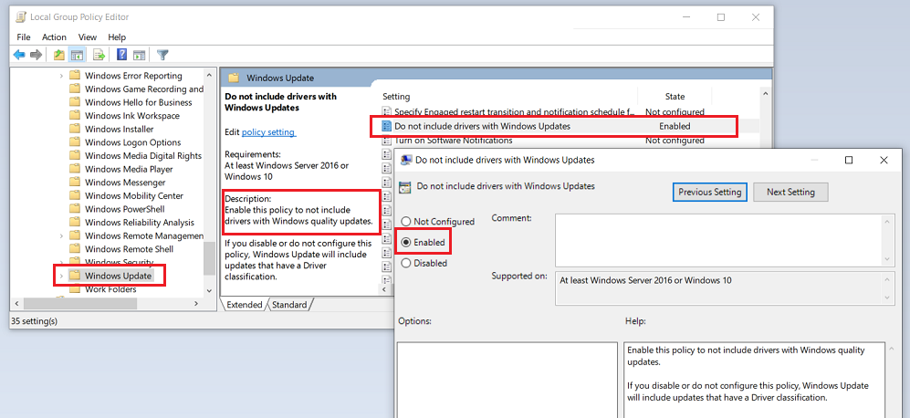

          Hi DKThompson:
          Just an aside, but a few years ago I had to perform an emergency recovery of my Win 10 Pro machine because it wouldn’t boot up and I suspect the problem was caused by a BIOS firmware or hardware driver update delivered by Windows Update during a Patch Tuesday.
          You stated that you don’t believe your mouse driver was damaged this month, but since you have a Win 10 Pro OS that includes the Local Group Policy Editor [open a Run dialog box (Windows key + R and enter gpedit.msc to launch] you might want to consider configuring Windows Update so it does not offer updates for your firmware and hardware drivers. See Option # 1 of the TenForums tutorial How to Enable or Disable Including Driver Updates in Windows Update in Windows 10. From my Win 10 Pro v22H2 laptop:
          Win-10-Pro-v22H2-gpedit-Local-Group-Policy-Editor-WU-Exclude-Driver-Updates-16-Nov-2023
          Dell Inspiron 5584 * 64-bit Win 10 Pro v22H2 build 19045.3693 * Firefox v119.0.1 * Microsoft Defender v4.18.23100.2009-1.1.23100.2009 * Malwarebytes Premium v4.6.6.294-1.0.2189 * Macrium Reflect Free v8.0.7690

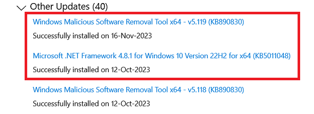

      It’s also possible the monthly scan with the Malicious Software Removal Tool (MSRT) that runs each Patch Tuesday (look for new definition sets in your Windows Update history under “Other Updates”) got stuck while scanning a file.
      You should also check under “Other Updates” to see if the KB5011048 Microsoft .NET Framework 4.8.1 for Windows 10 shown below that Microsoft started rolling out last month has been delivered.  Some users have reported that delivery of KB5011048 was delayed on  their Win 10 machines until this month’s Nov 2023 Patch Tuesday.
      WIn-10-Pro-v22H2-Windows-Update-History-Other-Updates-MSRT-Definition-and-MS-NET-Framework-v4_8_1-18-Nov-2023
