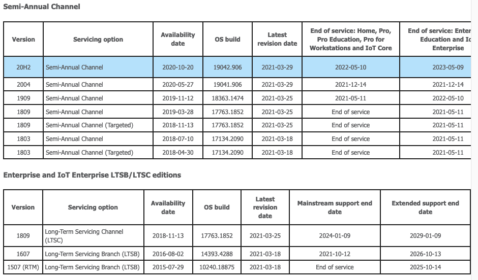

      Susan, I’m on Version 2004 (OS Build 19041.870). My GP for feature updates is set for 2004. Everything is working just fine for me.
      I’m confused why you’re suggesting an upgrade to (OS Build 19042.572) What advantages are there for me to change things now? Did I misread your post?
      I’m using Win 10 Pro. A Belarc scan today says I’m up to date.
      Peace,
      CAS
      • #2355353
        20H1 and 20H2 have the same code base. To upgrade to 20H2 from 2004, you install a simple enablement package turning on code that is already there. If you are already on 2004 the upgrade should be quick and painless. BUT, always make a system backup before beginning the upgrade process. You’ll end up with version 19042.870.
        The primary reason Susan recommends 20H2 is the longer support window. It is supported until March 2022. The support time frame for Windows 10 Home & Pro is 18 months from release. 2004 will be out of support this fall.
        • #2355376
          actually joep517, support for Win10 version 2004 will end in December 2021 as noted here (12/14/2021 to be exact)
          and support for Win10 version 20H2 Home/Pro will be up to May 2022 (not March 2022) as noted in the link page
      • #2355361
        Support window. It gets you to a longer window of time for updates.
        Susan Bradley Patch Lady

    • #2358013
      I was wondering about build versions vs feature update versions.
      I have Windows 10 version 20H2 with build 19042.867.
      This lists a build of 19042.928 with date of 2021-04-13, and it’s still for 20H2.
      https://docs.microsoft.com/en-us/windows/release-health/release-information
      If TRV is set to 20H2 and I already have 20H2, that should mean I will not get any updates. How would I get build 19042.928, presuming I wanted it?
      • #2358017
        20H2 is a version. Build 19042 signifies it is version 20H2.
        2004 is a version. Build 19041 signifies it is version 2004.
        Both of these are Feature (version) Updates.
        Build 19042.867 is version 20H2 with the March Monthly Cumulative Update KB5000802 installed.
        Build 19042.928 is version 20H2 with the April Monthly Cumulative Update KB5001330 installed.
        The .xxx on the end of the Build number tells you which Quality (Monthly) Update is installed.
        TRV selects the version you are on. It regulates the Feature (version) Upgrades.
        It does not effect whether you get Monthly updates or not.
