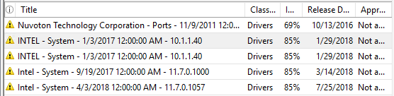

      I also have Intel System driver updates offered in WSUS, along with a Nuvoton, dated November 2011 through April 2018. Wondering why these ancient drivers are suddenly on offer–it seems they appeared after the upgrade to Win10 2004. Approve? Decline?
      Driver-updates

      Thanks everyone for their input in the replies above.
      Regarding the Intel System patch(es) I’ll err on the side of caution and stick to the old rule of not installing driver updates and similar from Windows Update and rather look for a download from whoever is the provider of the relevant hardware (Intel in this case). I’m interested to see whether woody will address these Intel patches in his latest Computerworld article and what his advice is.
      As for the Edge update, I will not install that one and I will consider whether installing ChrEdge as a separate program once I have updated 1809 to 1909 now that we are at MS-DEFCON 3.

      Found this article with some info on the old Intel drivers and why they are showing up now:
      https://borncity.com/win/2020/09/27/windows-10-bietet-alte-unpassende-intel-treiber-updates-an-sept-2020/
      • #2310839
        Found this article…
        Here are two other articles about an old Intel driver that is showing up, to prepare for 2004 (and maybe 20H2), it is said:
        Windowslatest, Dated Sept 28.
        Bleepingcomputer, dated Sept 29.
        Dell, HP, and Asus devices were targets. I got Intel – System – 10.1.15.61 with no date given, but after it installed, the date was there: 7/18/1968. It didn’t appear as an optional update either; it was in the WU legacy queue. Furthermore, after I hid the first push, another push came the next day and it couldn’t be hidden b/c the first one was already hidden, and so it appeared with a “Download” button, blocking anything else that would later appear for downloading. Microsoft was to have pulled it back in September. But, that didn’t happen.
