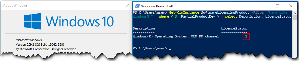

      You can also use PowerShell. Copy/paste the following into a PowerShell console (which doesn’t have to be elevated):
      slmgr /xpr
      Alternatively, use the following – but be warned… it’s very slow to return a result (25 seconds on an i5):
      Get-CimInstance SoftwareLicensingProduct -Filter "Name like 'Windows%'" | where { $_.PartialProductKey } | select Description, LicenseStatus
      powershell_activation_status
      A result of ‘1’ shows that Windows is permanently activated.
      Values:
      0=Unlicensed
      1=Licensed
      2=OOBGrace
      3=OOTGrace
      4=NonGenuineGrace
      5=Notification
      6=ExtendedGrace
