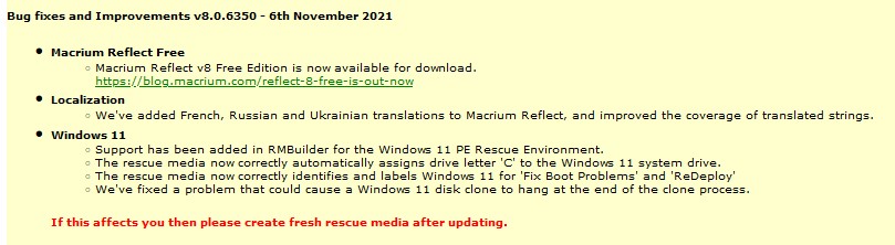

      Watch Macrium “Fixes-Improvements” Release Notes for — RED Font notices  — “IF This Issue Affects You — Create Fresh Rescue Media” …. This 11/6/21 example is the most recent I see – so not that often………..
      RED-TYPE-CREATE-NEW-RESCUE-MEDIA-
