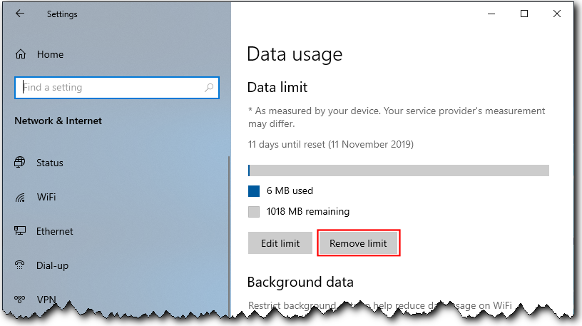

      The fact that it’s greyed out means that not only is the connection metered but a data limit has been set. Remove the data limit and the meter connection will become ungrayed.
      AFAIK there’s no method to do this via a registry edit. However, it’s so easy to fix that a registry edit is not needed. Here’s how to (using my Wi-Fi connection as an example):
      1. Click on the Change data limit settings link below the grayed-out connection:
      metered_connection1
      2. In the Data limit section, click on the Remove limit button then on the Remove button in the dialog which appears:
      metered_connection2-1
      Now return to the properties of the metered connection and you should find that the toggle switch is no longer grayed.
