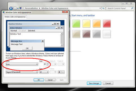

      • #1964855 Reply
        dg1261
        While the 25″ text is a little smaller, it’s certainly not objectionable. Icons may be a different story.
        Just so there’s no misunderstanding, let me be clear that my graphic only shows *relative* sizes, not absolute — relative sizes of the two screens, and relative sizes of text on the two monitors. I don’t know what settings you’re using on your system, but compare the text size in various places on your screen to my graphic and imagine them smaller by the same relative amount as in my graphic. (Or, you could resize my graphic until it matches the text on your screen.)
        I don’t know which OS you’re using, but in Win 7 and 8.1 you can change the size of the screen icons. In Win 7, the setting is under Personalize->Window Color->Advanced. I don’t know if it’s still there in Win 10, but if it is I’ve never found it.
        iconsize
        • #1965378 Reply
          Anonymous
          Inactive
          Windows 10. Not sure what you mean by “screen icons.” I have my desktop
          icons set to large.
          EDITED inappropriate formatting
