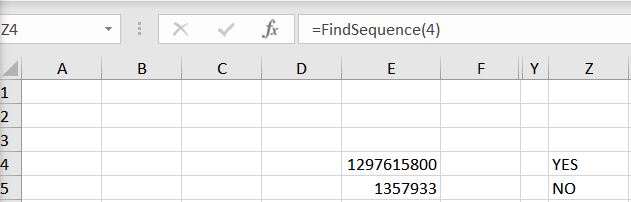

      Here’s a shot of the test worksheet where you can see the calling sequence and results of the test items:
      Sequenced-1
      HTH

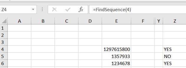

          Test Data:
          Sequenced
