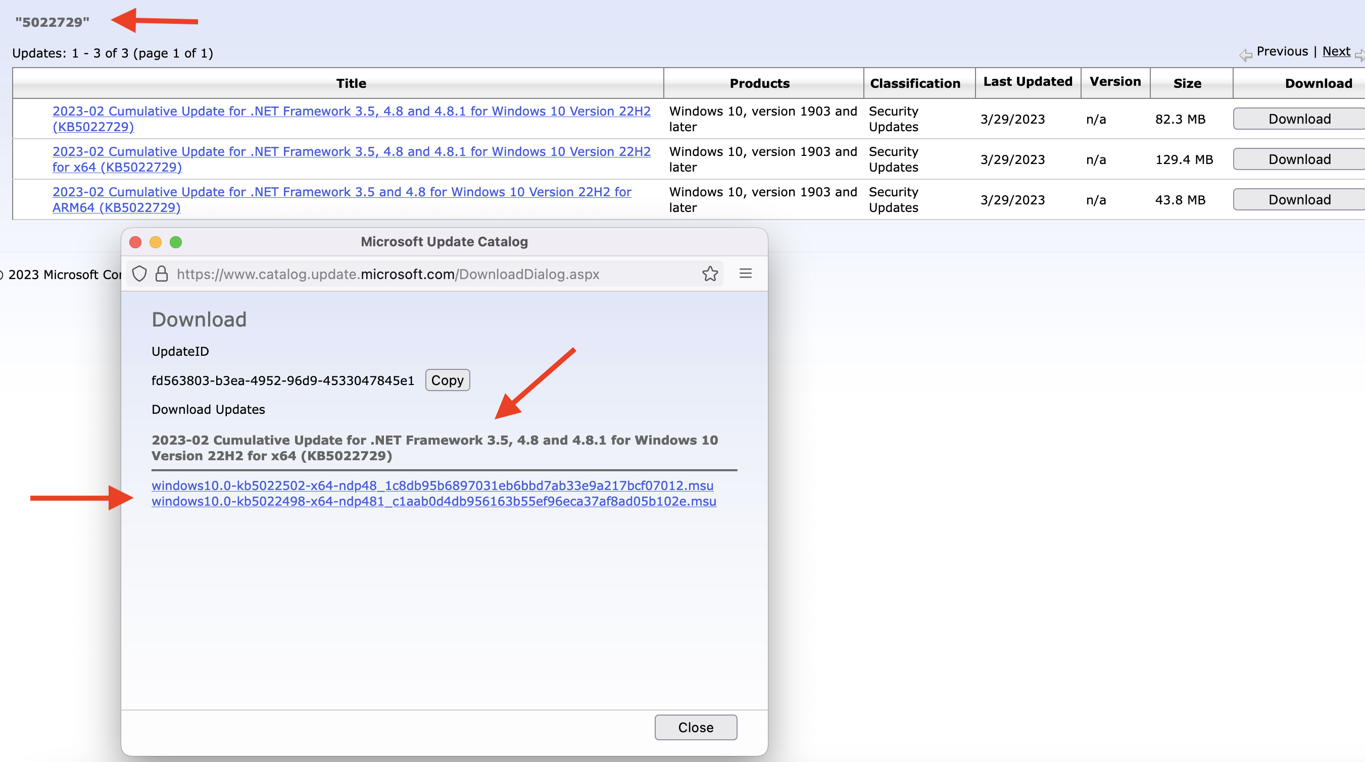

KB5031224 is a bundle (.NET 3.5, 4.8, 4.81)
It contains separate updates KB5030841 for .NET 3.5/4.8 and KB5030649 for .NET 3.5/4.8.1
It is not the bundle that is installed. It is the individual update. So it will depend on whether you have .NET 4.8 or .NET 4.8.1. The other may give you the error message. Are you sure you have both 4.8 and 4.8.1?

2023-02 Cumulative Update for .Net Framework 3.5, 4.8 and 4.8.1 for windows 10 version 22H2 for x64 (KB5022729)
If it shows “.Net Framework 3.5, 4.8 and 4.8.1”, it is the bundle. There are two updates contained in it, one of the is for 3.5/4.8 the other for 3.5/4.8.1.
Unless both 4.8 and 4.8.1 are installed, you will only get one of them for the one version you have installed. If you try to install the other one, you will get an error. Windows Update “Knows” which one you need. See catalog screenshot.

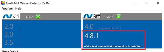

Which do you have installed? .NET v4.8 or 4.8.1?

Use the Asoft .NET Version Detector (available at https://www.softpedia.com/get/System/System-Info/ASoft–NET-Version-Detector.shtml) to find your installed .NET Framework version. This is a portable utility that can be run from any location so I unzipped the netver.zip file on a removable USB thumb drive and then double-clicked the dotnet.exe file to launch.
This utility shows I have .NET version v4.8.1. This .NET version just started rolling out to Windows 10 users and if I look under the “Other Updates” section of my Windows Update history I can see that KB5011048 (Microsoft .NET Framework 4.8.1 for Windows 10 version 22H2) was delivered with last month’s October 2023 Patch Tuesday updates.

Version and build number is 19045.3570 for one of my systems, the other system is similar and now thanks to you and PKCano guiding me along, I understand better how Windows bundles .Net Framework updates and now can easily check what is installed with the excellent Asoft.NET version detector you told me about.
