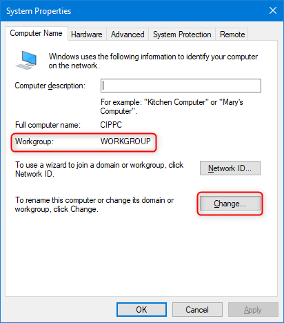

      hello and wellcome! I suggest you do this:
      1) Put both computers into same Workgroup (This PC -> Properities -> Put same Workgroup name on both computers). This will join them together.
      2) Create shared folders, or you can share whole partition too
      (Rightclick the folder/partition you want to share, go to tab “Sharing” and check the box “Share this folder”)
      After this is done, you should see the shared folders on your network.
      Lets start with this, then we can move on. This initial setup should help you, then you can decide, if you want just read or read and write from shared folders. But one step at a time.
      Let us know, if it went OK. Here is Youtube Video to help enable the function.
      workgroup
