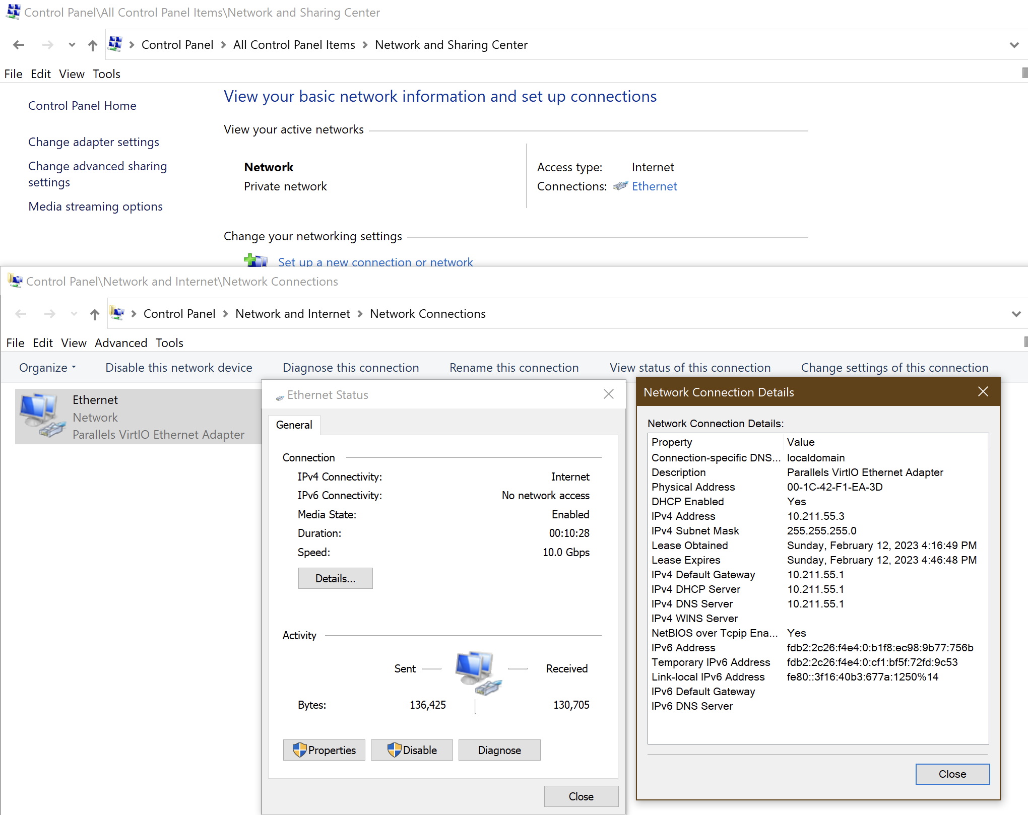

      In the menu on the printer:
      Give the printer a static IP address within the segment that the router. Look in Control Panel\Network and Sharing Center, access the wireless card (Change adapter settings) – Status – Details. Set the Subnet Mask and Gateway the same in the printer. Set the SSID and password the same as your wireless.
      Wireless-Settings
      In the computer, Control Panel\Devices & Printers. Right click the printer, choose the “Ports” tab. If the printer is connected to a WSD port, change it. Add a port – Standard TCP/IP Port – New Port. Follow with the static IP you assigned the printer and connect the printer to that port.
      Port

        In the menu on the printer: Give the printer a static IP address within the segment that the router.

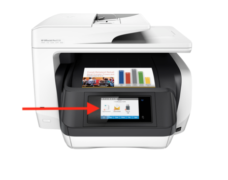

        When you say “Menu on the Printer”, where is that exactly? Is that where I make a connection to the printer to see ink levels, maintenance, etc.?
        • #2533789
          Most probably a touch screen on the front of the printer. On mine:
          Screen-Shot-2023-02-12-at-7.32.27-PM
          • #2534043
            Thanks PK but mine doesn’t have that. Also, I don’t seem to have the same options you show in your post on the printer as far as I can see. Probably because mine is older.
