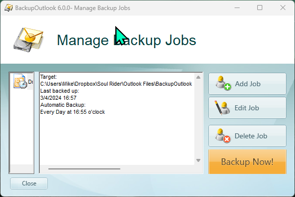

        There are no other waketimers shown in the command line interface. BackupOutlook is not shown there and it’s set to run at 4:55 PM inside its GUI. R-Drive Image is also set to run at 10:30 PM inside its GUI.
        So, Paul T, since BackupOutlook’s afternoon run is not shown in the command line interface, and both the afternoon and nighttime runs of R-Drive Image are not shown in the command line interface, where would the computer have stored those tasks to be run? In the Task Scheduler?
        Here’s a screen of the current Task Scheduler, in which are seen (a.) the 2 Notepad.exe events I created, (b.) all R-Drive Image run tasks which are a result of enabling that program’s own radio check box, but (c.) BackupOutlook is not shown although it was scheduled inside its GUI.
        mmc_mW12tttiQf
        Here also is BackupOutlook’s screen:
        BackupOutlook_VOPLRl4qAH

      Programs can have their own schedulers if they have a background task – common in backup apps. It looks like your apps have their own and expect the machine to be running for the schedule to work – hence the late run after you fired up the machine.
      I would work on the wake up via Task Scheduler to get the machine to wake, then sort out the backup.
