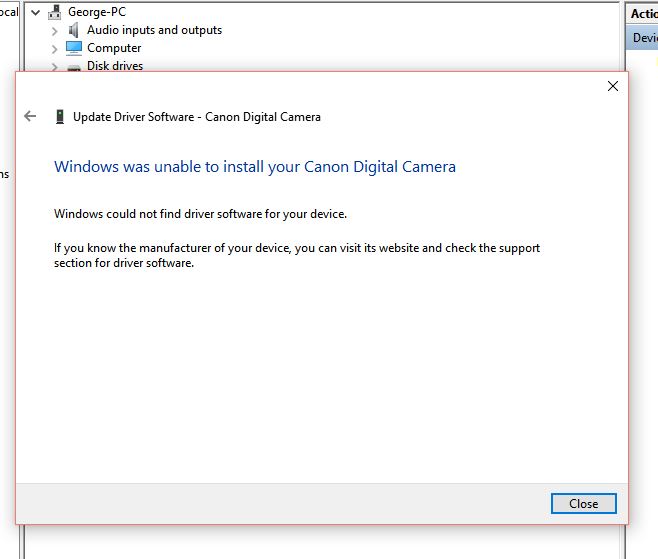

      If I go into Device manager the properties of the unknown camera device say no driver.
      Just a thought but have you tried hooking up the camera and opening Device Manager and see if you can get MS to search for it. I’m not on my W10 right now so not sure what shows up in your driver window, ie search for driver.
      Or as Sudo15 said, try the 8/8.1 driver and see if you can update it through Dev. Mgr.
      • #1565697
        Thanks for your reply.
        Yes I’ve tried that. This is what I get.
        44636-Capture70d4
