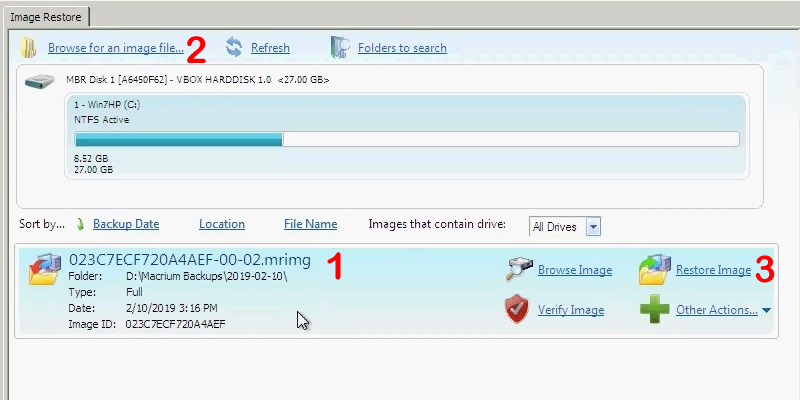

    • #2037025
      Yes, you’re following the correct sequence of steps.
      Once into the Macrium Reflect program, will it show my new HDD as a selectable Target drive to restore my old HDD backup image (Source) to? Any need for any formatting or disk layout changes on the new drive if want to restore exactly the same as the old HDD? Will the boot up from the USB Rescue Media stick be enough to initialize the new HDD?
      The new disk will be initialized by the Macrium program as part of the restore process. Do not do anything to prepare the new HDD beforehand. In fact, if you do, it will be undone by Macrium before proceeding, so any prep work would just be a waste of time.
      Here’s a few select notes to go with the following images:
      1. On the “Image Restore” tab, Macrium may remember the last image you made.
      2. If that’s not the desired image, browse for the correct image. Your external USB data disk should show up there.
      3. Then click “Restore Image”.
      4. This screen can be confusing. It looks like you’re copying from a hard disk, but note “Source” is actually the .mrimg file. So you’re copying from the disk contents stored within the image file, not directly from a disk partition.
      5. Click “Select a disk to restore to”. Your new, blank HDD should be an option on the next screen.
      The rest of the process should be easy enough to follow.
