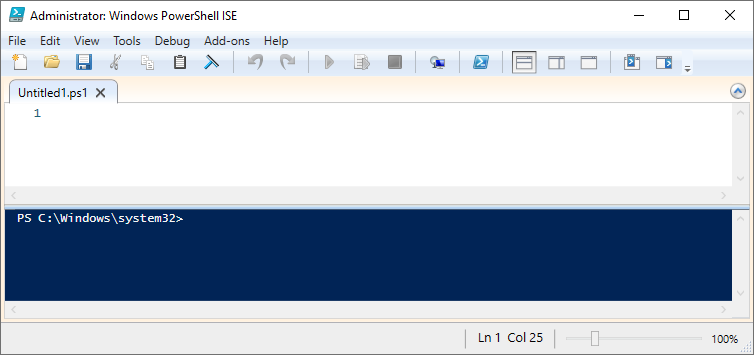

      I am missing the nice interface option and can only find the terminal option. Where is it??
      Do you mean the (deprecated) PowerShell ISE?
      ps_ISE_Admin
      That works with PowerShell 5.1 and older but not PowerShell 6 and upwards. Microsoft advice is to use Visual Studio Code with PowerShell extensions.

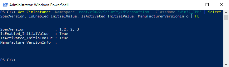

      In an elevated PowerShell console the first error you will get is about the unknown token named Class. Use ClassName.
      Try this for a simpler one-liner to get the specific information you were looking for:
      Get-CimInstance -Namespace 'root/cimv2/Security/MicrosoftTpm' -ClassName 'Win32_TPM' | Select SpecVersion, IsEnabled_InitialValue, IsActivated_InitialValue, ManufacturerVersionInfo | FL
      Note: I’ve only tested this using Win 10’s built-in PowerShell 5.1:
      ps_tpm

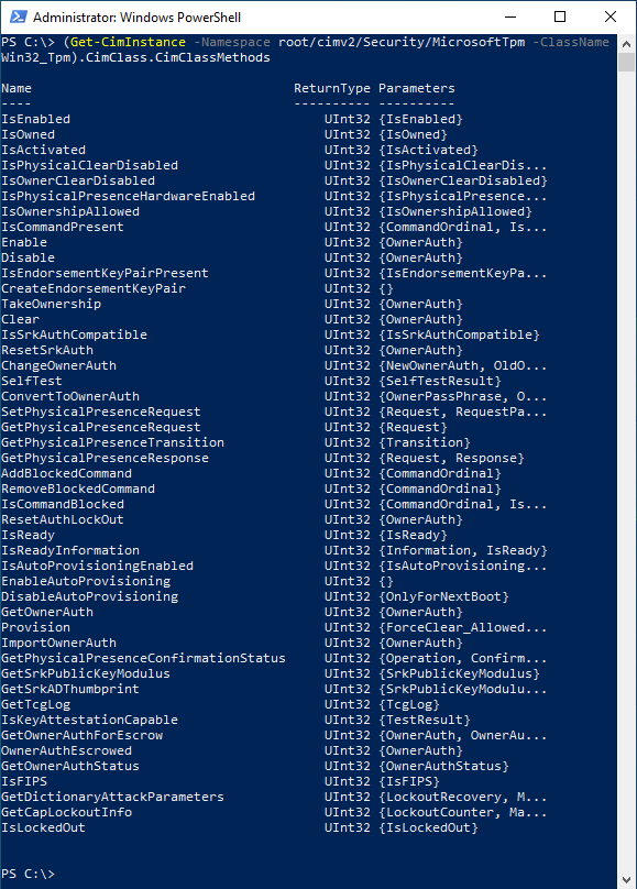

      To see all the available methods, use this:
      (Get-CimInstance -Namespace root/cimv2/Security/MicrosoftTpm -ClassName Win32_Tpm).CimClass.CimClassMethods

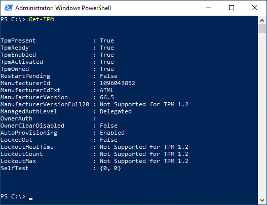

      I just use Get-TPM if all I want to know is whether TPM is activated:
      ps_get-tpm

      My only addition would be for the common WINDOWS user just keep using Powershell_ISE.exe to get the Integrated Environment. You can also use PowerShell.exe which will just give your the command environment, useful when running already developed and debugged scripts. This is a WINDOWS ONLY version
