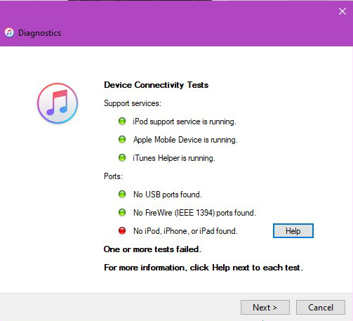

          Thanks Rick. I just loaded and I’m testing CopyTrans. It had zero problems communicating with an iPhone 7 Plus on iOS 13.6, and also found and gave me the option to restore all prior iTunes backups on the machine. The one on which I did a test restore needed it’s unique password, and CopyTrans authenticated it.
          Here’s the screenshot of the problem iTunes 12.10.7.3 reports which Apple wouldn’t solve.iTunes-fail
            That error suggests the problem is not iTunes but basic USB connectivity… so the first thing I would try is to beg or borrow another Apple USB cable.
            Are you using a genuine Apple cable? I find that the genuine Apple Lightning-to-USB cables rarely last long before the insulation in the super-thin cable breaks down and either data transfer or charging capability is lost.
            I now don’t buy replacement Apple cables but instead buy Apple-certified cables from reputable third-party manufacturers. Funnily enough, the very basic Amazon Basics Lighting-to-USB cable has proved to be as long-lasting as much more expensive braided cables except too short… so I have to spend extra to get a good quality 3m data/charge cable.

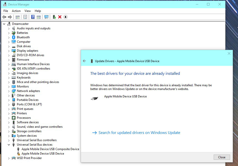

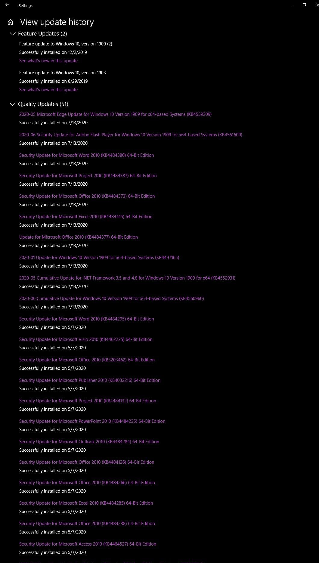

        So, if you are having an issue with the Apple mobile device drivers, it’s likely to continue to be an issue no matter what front-end you choose as a replacement for iTunes.
        That could be 🙁 And it seems this happened around the time of some forced Windows 10 updates shown in the second screenshot. Apple-Mobile-Device-driver-fail
        Windows-forced-updates
          Are you using the same Lightning-to-USB for both?
          • #2284386
            Michael Austin
            Nope. I’ve three different Lightning to USB cables and tested them all before considering them OK. Just now because you brought it up I’m re-synching the phone to the laptop using one of the cables used on the desktop. That’s working fine.

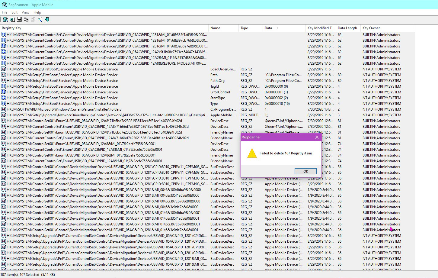

            What I’d like now is to know how to rip the pernicious weeds of Apple’s Mobile Device registry entries out by their roots. NirSoft’s RegScanner is showing me this but I need to know how to overcome it and delete them. I ran Revo’s uninstaller before this and removed everything Apple.
            Is there some secret, wizardly chant I must perform to nuke these?

              I’m having gradual success with the Registry hacking process. I’ve run NirSoft’s RegScanner, searching for “Apple Mobile”. When I started it found 107 keys. I’ve found and deleted several of those keys and also nuked some Apple .infs, and I’m down to around 90 keys. The phone now backs up and syncs via iTunes.

        An update:  iTunes 12.10.7.3 on a laptop running Windows 10 version 1909 connects successfully to the iPhone 7 Plus running iOS 13.6. I’m backing up the iPhone to the laptop now.
        It’s clearly the Apple Mobile USB Driver which is having problems only on the desktop. I’ve removed and reinstalled that driver and others from Apple several times.
        Methinks I might try a reputable uninstaller like Revo’s on the desktop to find and remove all traces of Apple software on the desktop, and then I’d try reinstalling iTunes to see if it behaves differently.
        I tend to use Nir Sofer’s USBDeview (run as Administrator) to uninstall the Apple Mobile Device drivers, especially when the problem is the device not being recognised.
        1. Just do a sort on the Description column so the Apple entries are together then select *all* the Apple entries – not just the Apple Mobile Device drivers.
        2. Right-click and choose Uninstall Selected Devices. This will remove their entries in the registry. (IMO this is much easier than using RegScanner.)
