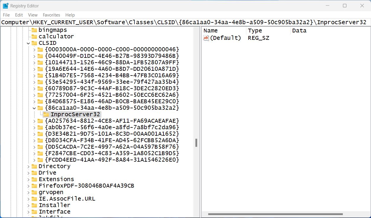

    Hey Y’all,
    After reading Susan’s email this morning (plus only) I tried out the registry entry to get the full context menus in file explorer back. Worked like a charm and I’m using Tiny11!
    For those of you who are loathed to mess in the Registry Editor I’ve attached a .Reg file that you can double click and merge into your registry. No muss No fuss.
    Download from here
    Moderator Susan note:  Made the edits to fix the typo. This time I exported from my working PC!

      The .Reg file was appreciated, but did not work for me.  I logged into my Administrator account to run the file and restarted the laptop.  The condensed context menus still appear.
      This is on a year old 16″ HP Spectre x360, running Win 11 Pro, Version 22H2, OS build 22621.2134.  I have not installed updates this month yet as I was focused on this issue after Susan’s email yesterday.

        I had the same problem so went net-hunting. The follow worked for me:
        (save the section between the asterisks as a .reg file, run and restart).
        [HKEY_CURRENT_USER\Software\Classes\CLSID\{86ca1aa0-34aa-4e8b-a509-50c905bae2a2}]
        [HKEY_CURRENT_USER\Software\Classes\CLSID\{86ca1aa0-34aa-4e8b-a509-50c905bae2a2}\InprocServer32]
        It seems the RetiredGeeks .reg works for some but some need to specifically enter a blank, despite that being the default value🤔

        There is a typo in your .Reg file the CLSID key should end with 50c905bae2a2 and not 50c905ba32a2  (change the 3 to an e).  I ran the original .REG file and like @tbkid found it didn’t work. I renamed the key in the registry editor then restarted the PC and now it works.

      This has worked for me
      [-HKEY_CURRENT_USER\Software\Classes\CLSID\{86ca1aa0-34aa-4e8b-a509-50c905bae2a2}]

      • #2590112
        Did you download my revised link?
        HKEY_CURRENT_USER\Software\Classes\CLSID\{86ca1aa0-34aa-4e8b-a509-50c905bae2a2} should be the working one as that’s what I have here at the office.
        • #2590121
          Very Interesting…
          Context Menu:
          Win11ExpandedContextMenu
          Registry Entry:
          Win11RegistryContextMenuSetting
          Well, all I can say is it works for me.
          UPDATE: I tried it with the 86ca1aa0-34aa-4e8b-a509-50c905bae2a2 and that worked also, go figure!
          UPDATE & APOLOGY!:
          Well I kept on figuring and finally remembered, hard at my age, that I had StartAllBack installed. Thus the fact that the wrong registry key worked because it wasn’t being used!
          SAB-Classic-Context-Menus
          SORRY EVERYONE!

      Susan wrote: “Made the edits to fix the typo”, but a new typo’ has now appeared in the .reg file at the “Download from here” link above.
      In the 1st line the Registery key correctly ends “e2a2}”, but in the 2nd line it ends “ea2}”, so the now missing ‘2’ character three places from the end of the key name in the 2nd line needs restoring.
      BTW: Often when making Registry changes these do not work immediately, but it is necessary to restart the PC before they work. I don’t know if that is needed in this case, but have people who found it did not work for them tried restarting their PCs? Just a thought.
    • #2590230
      Though I had restarted the computer after making changes to the registry each time yesterday I realize I never fully shut it down.  Over night it was shut down and upon restarting the computer this morning there is now a full context menu when right clicking.
      The .reg file I last ran used key names ending in ’50c905bae2a2′ and set a blank (@=””) after each of the key entries.  It worked and I’m not messing with it anymore.
