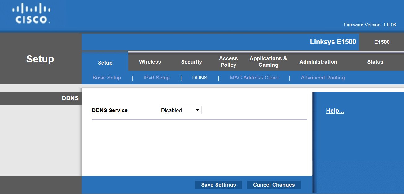

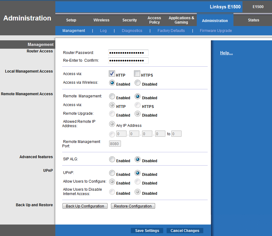

    • #2272233
      Here are some screenshots from my router.  I do have the last firmware offered.
      Screenshot_3
      cis3
      cis4
      • This reply was modified 3 years, 3 months ago by Larry B.

    • #2272239
      Here are 3 more:cis6
      cis5
      cis7
      Moderator edit, formatting

    • #2272300
      Thanks for the reply’s.  Looks like a new router it is.  A feature called “Speedboost” was messing me up.  Strange that wireless speed is 3X faster than wired speed.
