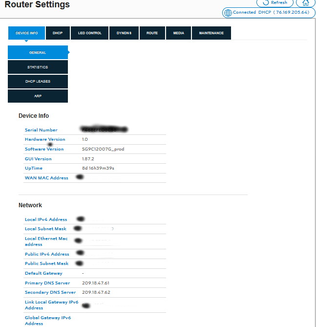

      OK, I managed to track down the place where I THOUGHT you were supposed to change the DNS settings (under “Internet Connectivity”), did so, hit “apply”, got a confirmation, went over to the dialog summary box under “Router Settings”, only to find that it hadn’t changed at all!
      Rebooted, got into the router again, same result.
      Ran ipconfig /all from the command line, and got nothing useful, just:
      DNS Servers . . . . . . . . . . . : 2001:1998:f00:1::1
      2001:1998:f00:2::1
      192.168.1.1
      Oh, and I changed “Automatically find DNS” to “Manually Find DNS” in the “Internet Connectivity” dialog…could that have something to do with this dichotomy? I thought it would force it to use what was specified, i.e. the Open DNS servers.)
      OK, what the *&^$!! is going on here? Screen dumps with some info redacted attached.
      How can I truly tell what DNS server/s I’m going through? Sagemcom and Spectrum seem to have a riddle wrapped in an enigma stuffed into a latrine here! Now I know why I never took up networking; I have no mindset for it, and appreciate those who do! 🙂

        In your 2nd pic “Router Settings” under “Network”, I believe the DNS settings shown here are not your manual OpenDNS server settings but are the DNS server addresses that are being provided by your ISP.
        My Linksys WRT1900ACS Troubleshooting Logs page (looks similar to your Router Settings page) shows the normal ISP provided DNS server addresses just below my public address info but scrolling further down my Troubleshooting Logs, my manually set DNS server addresses are also displayed.
        Your Sagemcom “Router Settings” page may (or may not) scroll further down to show this additional information but fortunately, there’s a very simple way to test to see if your router is indeed using the OpenDNS server addresses vs. the ISP supplied DNS server addresses.

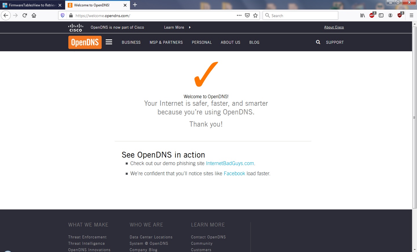

        If your Internet Connectivity is still set up as depicted, go to the “OpenDNS Welcome” page to test if your using OpenDNS servers for DNS services.
        If the OpenDNS Welcome webpage looks like this, you’re using OpenDNS not your ISP provided DNS servers …

      My Linksys WRT1900ACS Troubleshooting Logs page (looks similar to your Router Settings page) shows the normal ISP provided DNS server addresses just below my public address info but scrolling further down my Troubleshooting Logs, my manually set DNS server addresses are also displayed. Your Sagemcom “Router Settings” page may (or may not) scroll further down to show this additional information
      It didn’t. I really dislike this router. I had a Linksys than ran Linux years ago…loved it. I had to put a muffin fan on it to keep it cool in Summer, but it was hands down the best I ever had. Think it was a WRT series, too.
      but fortunately, there’s a very simple way to test to see if your router is indeed using the OpenDNS server addresses vs. the ISP supplied DNS server addresses. If your Internet Connectivity is still set up as depicted, go to the “OpenDNS Welcome” page to test if your using OpenDNS servers for DNS services. If the OpenDNS Welcome webpage looks like this, you’re using OpenDNS not your ISP provided DNS servers … OpenDNS
      Yup, all looks well!
