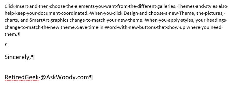

      One way to accomplish this is through AutoCorrect. I setup an entry called MySign so that when I type that it places my signature block at the cursor position.
      AutoCorrect
      I found the easiest way to set this up is:
      1. Open a blank document.
      2. Type and format the block as desired.
      3. Highlight and Copy the block.
      4. Goto File -> Options -> Proofing -> AutoCorrect Options.
      5. Your block should already show up in the the Replace text as you type With block with the Formatted text button selected.
      6. Just type your block name in the Replace space.
      7. Click the Add button.
      8. Click the OK button.
      9. Done.
      AutoCorrectDialog
      So you just need to setup a separate entry for each of your signature blocks and give the appropriate names. Make sure the assigned names are NOT something that would be normally typed!
