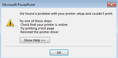

        I just changed the “spooling” option to “print directly to the printer,” but now nothing will print; instead, I get the following error:
        error
        Do you think this means the problem lies with my printer, rather than PowerPoint?
        Thanks again.

          Well.
          Having it print the first page means the print job made it to the printer driver and then out from there, and then that stopped. Usually this means a printer driver error.
          I’m not at all surprised that PowerPoint triggers that kind of thing – seen it before, too. Might be related to slide complexity, or not.
          If it works when exported to PDF and then printed from that, great – that’s probably the easiest thing to do then.
          One thing I’ve noticed recently is that old HP print drivers have started generating errors on some print jobs, possibly due to some of the Windows updates… printer driver isolation seems to help some. (Not MS Office updates, some of these cases don’t have MS Office installed at all.)
          If that’s the case, it just might work with a different print driver version – if you were already on the latest PCL6 one, a M477 should be able to also take at least PCL5 and likey also PostScript…
