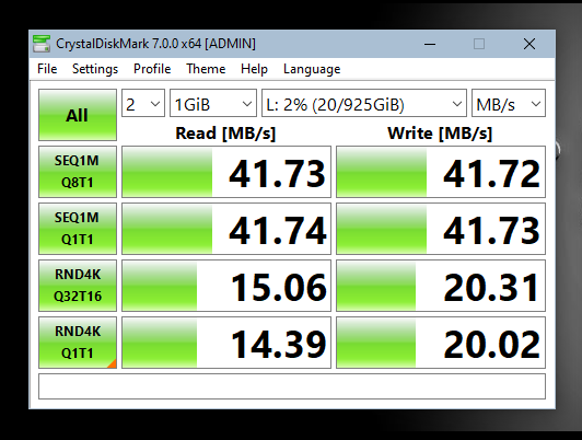

      Firstly, thank you all for your input, ‘much appreciated but I’m reaching the point where I think I’ll just leave this issue for now. Maybe I’ll tinker around and see if I can improve things a bit.

      I ran CrystalDiskMark and the difference between my System drive Samsung SSD 860 EVO and the USB drive, Samsung SSD 860 QVO is absolutely massive, but it seems I can’t post screenshots here…
      • #2262584
      Correction, I was shown how to add the attachments, thank you!!
      USB-Drive-Samsung-SSD-860-QVO
      System-Drive-Samsung-SSD-860-EVO

        Those numbers are problematic in both cases.  The 860 Evo is a SATA SSD, but you’re showing numbers far higher than the fastest NVMe drive currently available. There is probably some kind of caching program in use, perhaps Samsung RAPID mode from Magician.
        As for the other one, those numbers are slow even for an external conventional hard drive.  That performance you’re seeing is typical of a USB 2.0 connection.  For whatever reason, your USB connection is operating at USB 2.0 speed.
        If this is Windows 7, it could be that your USB 3.0 drivers are not installed.  The OS doesn’t do this automatically… if you don’t manually install them, it operates at USB 2.0 speed.  Win 8 and 10 should work with USB 3 out of the box.
        If that’s not it, either the adapter is really USB 2.0, or the USB port is USB 2.0.  Narrowing that down will suggest the next step!
