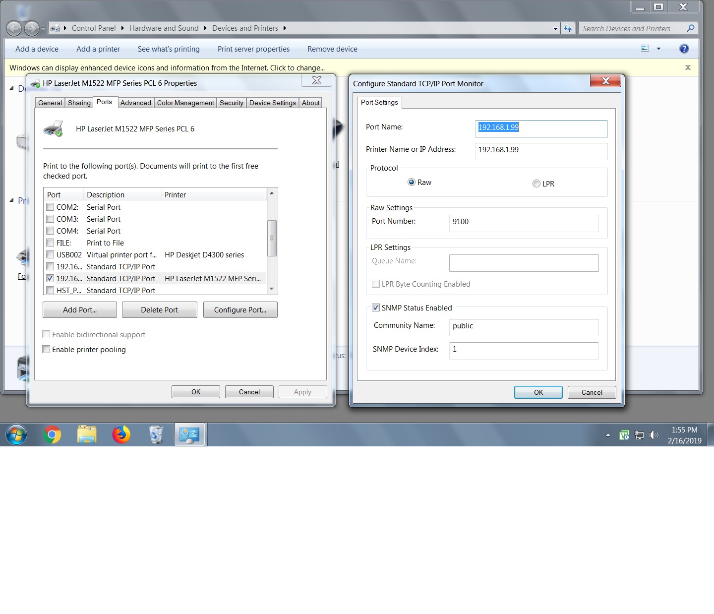

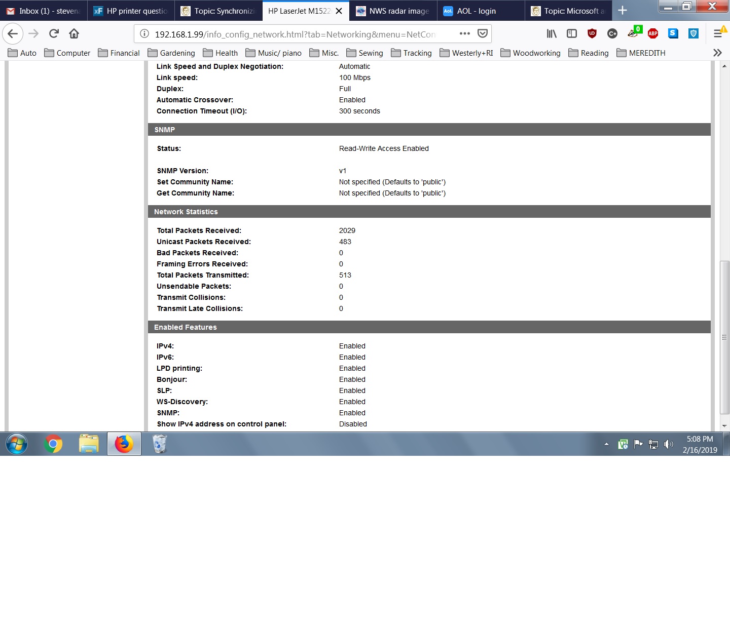

      Printers screenshotOP here- network wiring now reconfigured, printer has dedicated cable and IP address.  Running the second cable went fairly easily, once I thought about it- about an hour to snake the cable.  Cable from PC to printer now removed.
      The bad news is that the computer cannot find the printer now using the former default method.  The scan and copy functions work as before.  This s/shot is Start>Devices and Printers, bottom row #s 4-8 all relate to the printer in question.  Note that #5 is the default and the pop-up shows “offline.”  Print requests go into the queue and stop.  However, printing is successful using “Universal Printing,” whatever that is.
      The computer acknowledges the printer’s IP address, which I entered.  The ping test shows the connection to be correct, as does (I assume) the fact that Universal Printing works.  So… where to go from here?
      EDIT- unable to add image to this post- Help?

        You need to go to the HP printer software and add a printer. This time it will be a network connected printer instead of USB. The “printer” icon you have in devices and printers is looking at the USB port instead of a TCP/IP port.
    • #327217 Reply
      Slowpoke47

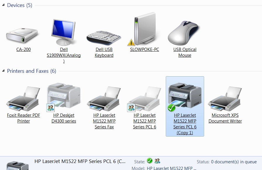

      I did do that, had to reinstall the printer software since I could find no way to change that setting.  But on reinstallation, that choice is offered, and I took it.
      Slowpoke (group B)
      • #327248 Reply
        Da Boss
        If you have more than one icon in devices and printers for your printer, right click on each one and choose “Printer properties”, choose the “Ports” tab. Find the one with the TCP/IP address box checked and make it the default (right click again on that one and check “set as default”). Then right click on the printer again, “Printer properties” and on the General tab, Print a test page.
        Now, in the software you need to print from, you have to choose that printer as the default.
    • #327262 Reply
      Slowpoke47
      If you have more than one icon in devices and printers for your printer, right click on each one and choose “Printer properties”, choose the “Ports” tab. Find the one with the TCP/IP address box checked and make it the default (right click again on that one and check “set as default”). Then right click on the printer again, “Printer properties” and on the General tab, Print a test page. Now, in the software you need to print from, you have to choose that printer as the default.
      The sequence is not exactly as you describe- under the “ports” tab, the correct port is checked, but right-clicking it doesn’t do anything.  There is a “configure port ” button under the list, which lets me see the IP address, etc., but pop-ups continue telling me “unable to find.”  Print jobs stay in queue.

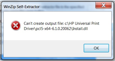

      OP here- still in trouble.  Couple of hours ago reinstalled the software using the Wizard, all went fine, printed test pages, etc. I was ready to report success.
      Just tried to print another test doc and the computer once again can’t find the printer, “offline.” :angry: Pages go to queue and stop, as before.
      Network connection active, printer “ready” shows on screen, software in computer installed w/ network option selected, proven by several test pages about an hour ago. Now- no go.
      Worked fine earlier, no changes made in the interim, now back in the hole.  Comments?

        OK, the problem is probably that the printer is set up on DHCP. With DHCP, the router assigns the IP addresses arbitrarily – the first thing that logs in gets the first IP address, the second gets the second IP address, etc. So things do not always have the same IP address – it’s a “whoever gets in line first” thing. Every time things are shut down and turned back on the order/address can change.
        When you installed the HP software, the printer had one IP address and the software noted that and assigned that address in the printer properties (remember the “Ports” tab in the properties?). Well, next time the printer may get a different address, and the software on the computer is still looking for it at the first address. So it doesn’t find it….and it doesn’t work.
        The solution is to assign the printer a STATIC IP address so it’s IP stays in the same place. I am going to give you the example of my network – you will have to plug in the IPs that are equivalent on your network.
        My router’s IP address is 192.168.1.1 and it is set as a DHCP server (gives addresses to the other things on the network). It has 255 addresses in it’s range: 0-254. Normally, the things that log in (computers, phones, tablets, etc) get the lower numbers. So to keep the printer out of that I assign it the address 192.168.1.200 (I don’t have 200 devices logging in). This is done in the PRINTER menu on the printer itself (Settings/network settings – set up network manually). The other numbers you will need to know are subnet mask (which is usually 255.255.255.0) and default gateway (which is the router’s IP, in my case 192.168.1.1). You will also have to know your network SSID and password (the same network name and password you put in when you connect a phone wirelessly).
        Now, when you install the HP software, it finds the printer and adds the IP address to the software on the computer – and the address is still the same next time so the printer doesn’t get “lost.”
          That’ll again depend on specifics. Some routers (yes, even some “home” models, and they usually don’t advertise this anywhere…) do keep a list of DHCP clients by network adapter hardware id (also called “mac address”), even over router reboots.
          Also some printers and printer drivers use an autodiscover feature that theoretically lets them function even with changing IP addresses as long as they’re in the same LAN broadcast area…
          Some routers are just “helpful” and set a broadcast area border between wired and wireless LAN even if they’re in the same subnet, for security. Even some detached wireless access points do this. (The various kinds of weirdness found in consumer-grade wireless access points would be a long story…)
          In some cases it’s also possible to configure the router / DHCP server to always give the same IP to a given mac address. This may be more common than the permanent list of clients but requires access to router configuration at a minimum, and even if the router has this capability it may not be easy to use.

      OK, the problem is probably that the printer is set up on DHCP. With DHCP, the router assigns the IP addresses arbitrarily – the first thing that logs in gets the first IP address, the second gets the second IP address, etc. So things do not always have the same IP address – it’s a “whoever gets in line first” thing. Every time things are shut down and turned back on the order/address can change. When you installed the HP software, the printer had one IP address and the software noted that and assigned that address in the printer properties (remember the “Ports” tab in the properties?). Well, next time the printer may get a different address, and the software on the computer is still looking for it at the first address. So it doesn’t find it….and it doesn’t work. The solution is to assign the printer a STATIC IP address so it’s IP stays in the same place. I am going to give you the example of my network – you will have to plug in the IPs that are equivalent on your network. My router’s IP address is 192.168.1.1 and it is set as a DHCP server (gives addresses to the other things on the network). It has 255 addresses in it’s range: 0-254. Normally, the things that log in (computers, phones, tablets, etc) get the lower numbers. So to keep the printer out of that I assign it the address 192.168.1.200 (I don’t have 200 devices logging in). This is done in the PRINTER menu on the printer itself (Settings/network settings – set up network manually). The other numbers you will need to know are subnet mask (which is usually 255.255.255.0) and default gateway (which is the router’s IP, in my case 192.168.1.1). You will also have to know your network SSID and password (the same network name and password you put in when you connect a phone wirelessly). Now, when you install the HP software, it finds the printer and adds the IP address to the software on the computer – and the address is still the same next time so the printer doesn’t get “lost.”
      Thank you.  Please see my screenshot, posted today, from the troubleshooter function for the printer.  Do I have to do something about this, before or after I follow your advice?
      Slowpoke (group B)
      • #327890 Reply
        Da Boss
        No, just set a static IP in the printer menu and install the HP software so it sees the static location. I can almost guarantee that is the problem you are having.
    • #327919 Reply

    • #327926 Reply
      Slowpoke47
      Restarted PC as a test- now printer is once again “offline.”  The new IP shows correctly on printer screen, in Properties (see attached) and the router has the new IP also.
      I thought I followed your steps, but I must be missing something.  Sorry for being so dense about it.

    • #327997 Reply
      Sueska
      @slowpoke47. First, PKCano’s advice is 100% on. The only thing that would work consistently for me was a static IP address. My printer is an HP1505n (believe it was purchased around 2007) for which I struggled with similar problems. What was most helpful for me was to print a self test configuration page from the printer. Not exactly sure of your printer setup. Turning on the PC may not be needed yet, but to cover all bases, turn on your computer. You will need it in a minute anyways.
      Print a Printer Self Test/Configuration page using a special keyboard combination on your printer. Check your printer manual for the exact instructions on how to do this. I found that my printer’s manual was NOT correct and  I had to – Turn on the printer 1st. Press the green go button and red X at the same time and keep holding it down until a page starts to print.
      From the printer self test configuration page you will see what ip address is assigned to your printer.
      Go back to your computer. You should be able to access the printer settings in a browser by typing in the IP address shown on the printer self test configuration page into the address bar of your browser. If it does not work try using another browser. My browser displays the name of my printer and several tabs.
      Look for a menu to allow you to enter the same static IP address that you added during the setup of your printer. In my case I selected the Networking Tab, Put a dot in manual ip address and changed the IP address to the static IP chosen early. Select apply.
      For good measure reboot the PC and turn the printer off and back on. Caution be sure to use the same key combination on the printer when printing your  self test configuration page. In my case using the same key combination starting with the printer off , wiped out all my printer settings and put back to dhcp defaults. Meaning I had to put the static ip address in the printer setting page in my browser all over again.
      Good luck, it is worth the effort once is working well. Advice to write down details what you did once you get it working, because one day something may wipe out your printer settings and you will need to repeat.

      Many thanks for your patience on this.  I believe I did enter those three numbers but obviously I’m missing something and I’ll try it again.  Apparently I’m not clear on exactly is done to set a static IP address.  I was just able to get a response from entering the new (i.e. 192.168.1.99) IP address for the printer, link attached
      https://192.168.1.99/set_config_networkIdent.html?tab=Networking&menu=NetIdent
      Slowpoke (group B)
      • #328008 Reply
        Da Boss
        That link isn’t going t work. It has to be https://  But the “Select File” box should be availabel for you in the lower left of the entry to attach a picture/screenshot..

      Slowpoke47
      This covers the opening screen, header clipped to fit in two s/shots.  Printer software currently reinstalled, so printer will work correctly until PC shut down.
      HP1
      HP2

      4 software installations complete from HP site- main driver package and 3 more recent updates.  PC still cannot find printer, shows “offline.”  Start>Devices and Printers>(icon)> Printer Properties shows correct info,  (same)>Properties mostly blank but has the printer name.  Reports generated directly from the printer show the IP, etc. as being correct.  The troubleshooter option in the corresponding pop-up in Devices and Printers returns nothing.  PCL6-screenshot
      This pop-up appears for two of the smaller installations, notice- “please wait…”  One hour later, still there, clicking “Finish” closes the pop-up, installation pop-ups  say “successful”  except for one, generates this message HP-error-message
      Unable to determine why the PC cannot find this printer.  I know I asked this before, but is this worth looking into? Problems-found-screenshot-1  We know the network connection is good- successful ping and test page yesterday, and green signal light on back of printer shows ok.
      Is there a way to tell the PC to look for this printer?

      Update- installed a second instance of the software, see shot of current Devices and Printers:
      Untitled
      Note that the newer version is a different icon.  With this as the default printer, printing is successful.  Rebooted PC (the Achilles heel of yesterday), this icon still shows “ready” and prints on demand.  The original one, to the left, is still ghosted, no idea why.  Don’t care either, as long as printing function is ok.
      Never did achieve my original intent, to sync time/dates.  I’m certainly going to let that sleeping dog lie, learned my lesson.  As of now, looks like the new network config is working as expected, good enough for me!  Can’t thank you enough!
