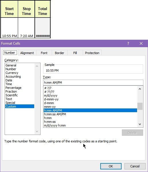

    =IF(V405=””,””,W405-V405)
    V & W are sleep start and sleep wake times.  The formula works fine as long as the times are on the same day, but fails if the times cross the day boundary.
    I did some searches.  Saw something that seemed to say that I needed to change the FORMAT I was using for this to work?  But doing so, didn’t seem to solve the problem.
    This shouldn’t be rocket science!

        That did not work for me.  Let me try and post the screenshot image yet again.  This time I converted it to JPEG instead of PDF.
        Excel-time-calc

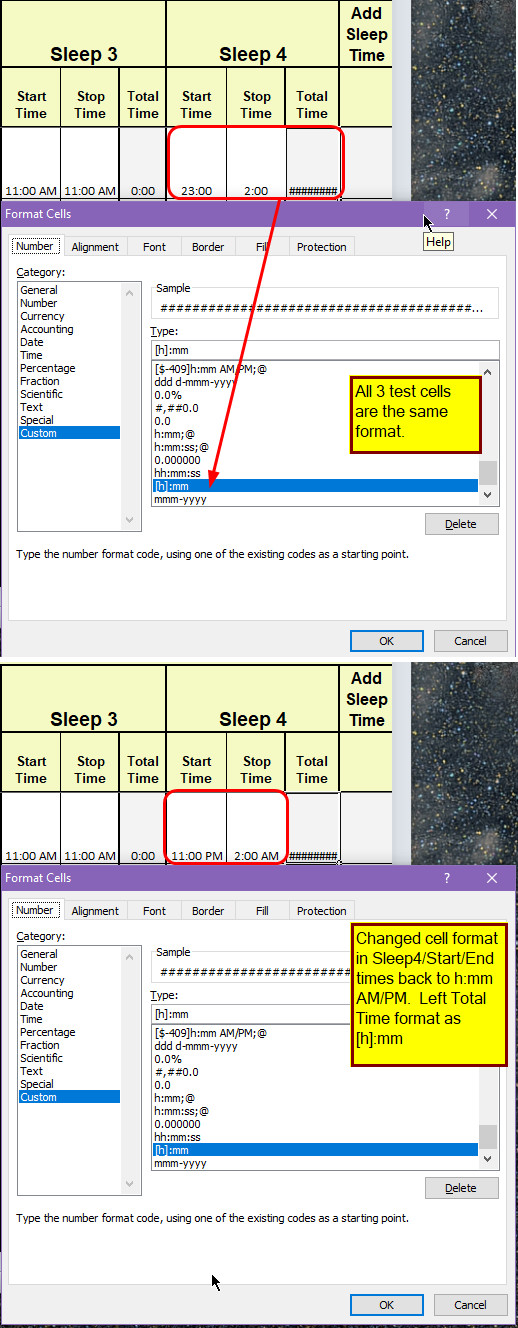

            I tried testing this today.  Unfortunately, it did not work.
            Attached is a screenshot.  Any idea what I might be doing wrong?
            This is the formula you gave me that I am using in these test cells:
            =IF(V4<W4,TIMEVALUE(“23:59”)-V4+TIMEVALUE(“00:01”)+W4,W4-V4)
            Excel-date-calc-2022-02-27-1
            • #2428188
              Ignore previous post – I wasn’t logged in.
              The test should be later time < earlier time. In my case B3<A3 or in your case W4<V4. Full formula should be:
              =IF(W4<V4,TIMEVALUE(“23:59”)-V4+TIMEVALUE(“00:01”)+W4,W4-V4)
              See how that goes.
            • #2428261
              OK, that seems to work now.
              BTW: I had to change your quotes.  Excel was generating an error and I couldn’t figure out why.  Retyping the quotes fixed the problem.  Thanks again.
