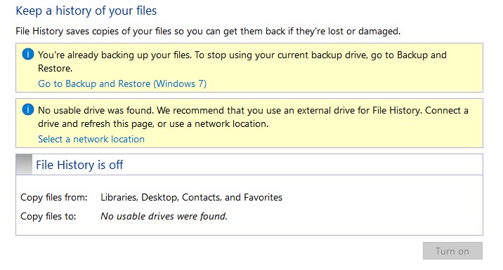

        First of all, File History was apparently always off or at least it was when I found it.
        2020-02-11file-history-

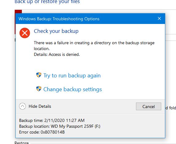

        My old external HD, Passport Ultra, is damaged and fails even the WD Quick Drive Test.  But I tried it anyway, as it was the only other one I had.  Turns out when system image failed, instead of just sitting there a 97% it gave some error messages.
        2020-02-11-backup-on-bad-wd-passport

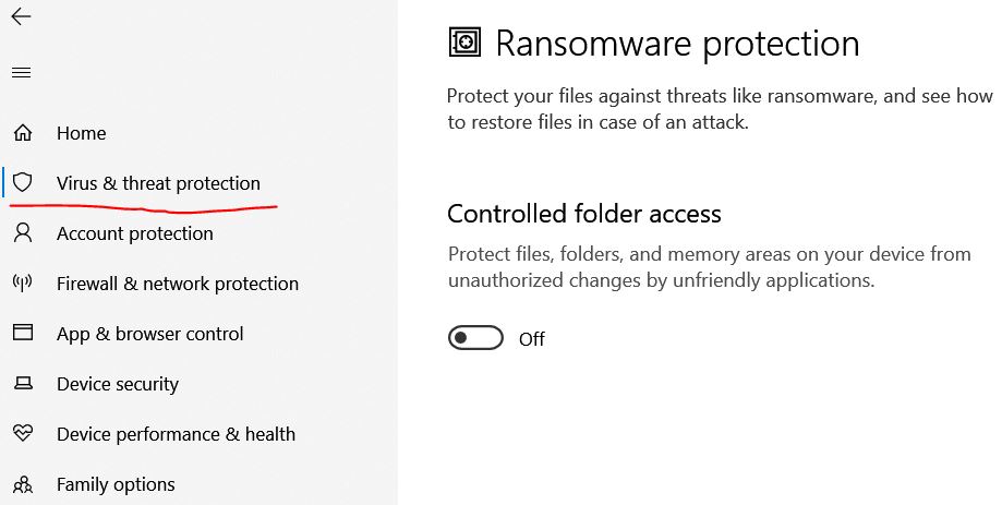

        Also, some alerts from notifications popped up and I gave permission to each one.
        2020-02-11-protection-history
        That did not work so I just turned off Virus and Threat Protection>Ransomware Protection>Manage Ransomware Protection>Controlled Folder Access>toggle to off
        2020-02-11-Controlled-folder-access
        System image failed again.
        2020-02-11-back-up-on-bad-wd-passport-b
        Volume Shadow Copy Service keeps stopping no matter how many times I set it to run automatically.  So I checked that and it was off again and I started it.  I also checked Windows Backup while I was there and it was running.
        Failed again but with a different error message.
        2020-02-11-backup-on-bad-wd-passport-c
