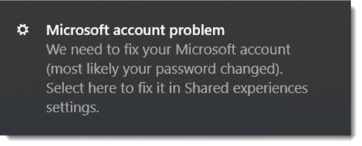

      PROBLEM
      Rebooted and I get a message we need to fix your microsoft account. Click here to fic it. Never saw this before . What’s up????
      I always logged in as local user if I recall.
    • #2343137

      • #2343142
        Never ran into this before.
        Try the “shared esperience” and the “log out log back in” in the first two links first.
        If those don’t work, try the #6 in the third link.

      All my account settings like correct. I have NOT clciked the notification yet. Still reading.
      Coincidence? Or something I changed to bring this about?
    • #2343146

      OK, Clicked the notification which took me to the Shared Experiences where we already found out no errors to be fixed! Notification gone. So what remains is to reboot and see if it comes back. Cross your fingers. And still reading as I do all this.
    • #2343155
      Read #6 in that last link.
      If you don’t find anything else amiss, I’d suggest log out and log back in.
    • #2343158
      OK. Its gone.
      I clicked the notification, took me to Shared Experiences. All was good, made no changes. Then closed settings, rebooted and done.

          Gonna take this opportunity to mention a few changes after the Login Notification AND DISM (don’t know which is/was the cause)
          1. My NAS which is mapped lost its password and had to be reentered on reboot
          2. .log files default app was changed to Notepad
          3. All I have found so far. Not looking, but noticing changes as they are presented.

      Wanted to note that in doing everything up to SFC, Three things have changed and all fixed:
      1. The Windows Login Error above
      2. .log files changed the default app to Notepad. I had it set otherwise
      3. My mapped NAS lost the password to connect and needed to be reentered.
      Might be more, but these were the only changes I have come across. If it has any interest.
